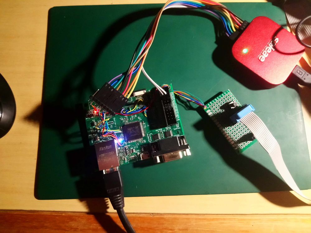

Hello, F407VET TQFP100 on custom board, ethernet PHY LAN8742A, STMCUBEIDE 1.6.1 on Linux (mint).
PHY and MCU both clocked by 25MHz oscillator, reference clock 50MHz is OK. Cpu running @168MHz
FREERTOS 3 task:
default init LWIP, start HTTPD thread then feed TCPIP ECHO server
Task1: feed UDP Echo Server
Task2: managing RGB led
Task 2 is OK but no signal come from Ethernet remain in idle color fading.
default task init LWIP, start HTTPD task, release init flag enter loop..
task 1 Ethernet echo enter loop after flag released.

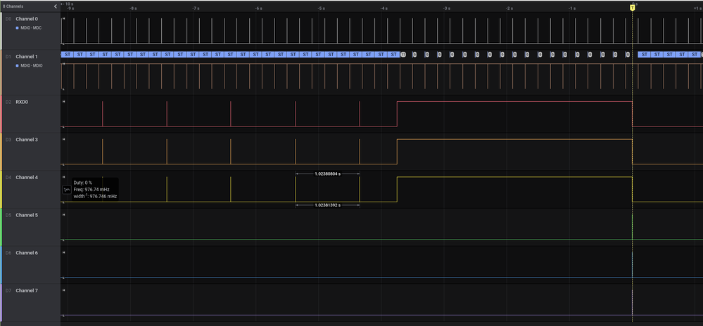

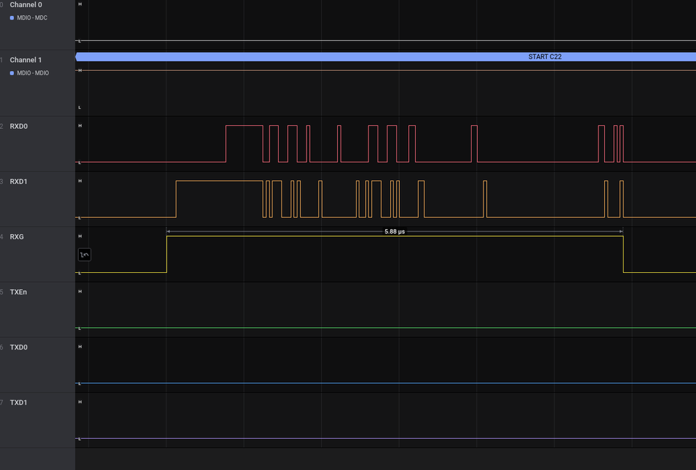

Checked MDIO Bus activity with Saleae Logic 8 pro it show PHY doesn't complete initialization:
control register address 0
status register address 1
interrupt source flag register address 0x1d
special control/status register address 0x1f
Register 0 two state were found decode:
0x7809 decode to -> all 10/100tx mode enabled, auto negotiation not complete, link down.
0x782d decode to -> all 10/100tx mode enabled, autonegotiation complete Link is UP
register 10 0x41 decode -> 4 reserved flag, 1 crossover time extention enabled
register 1d 0xca decode -> Energy EON, Autonegotiation complete, Autonegotiation LP Ack, Autonegotiation page received.
bit 0 is reserved so why write 1 when default to 0???
write register 0 phyadd 0 0x8000 (Software reset)
repeatedly read register 0x1f Phyadd 0x1f (??) result 0xffff (Open bus)
read register 1 Phyadd 0 result for a while 0x7809
after many poll status change to 0x782d
write register 0 phyadd 0 0x1000 (Auto Negotiation)
read register 1 Phyadd 0 result 0x782d
read register 0x10 Phyadd 0 result 0x0041
read register 0x1d Phyadd 0 result 0x00ca
write register 0x1d Phyadd 0 result 0x00cb
no more action appear on MDIO bus
No visible activity on rx tx PHY lines
Link led active solid.
Activity led pulse on ping packet
pcb is 4 layer, need some fixes due was planned for F429. Components shortage forced a change to F407, on this SPI 4 not present require some fix but nothing to do with LAN interface.
Has someone idea of what can be wrong? Read Piranha post but leave us at ground level, say what wrong ( I fell can be too) but no idea where are located (VERY) sparse files of Ethernet module.

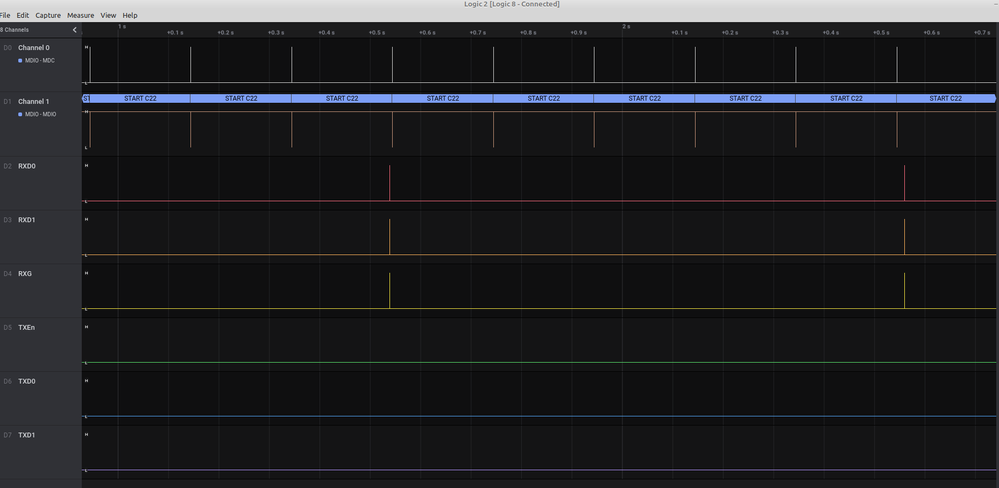

2021-07-19 8:28 AM
Update:
Connected all RX TX wires to get a more stable probing.
RX Gate and data is present, TX is missing. TX pin tested redeclaring as Output then driving in a sequence. Pin are OK
Work in progress still no idea from where trouble come from.Edit1: Found some hint from Majerle Tilen Site about Pin A8, try'd use as MCO but nothing changed.
Edit2: PHY configuration is ok, can work untouched too with resistor strap initial config. Issue come from MAC part, no transmit. Is Ping/ARP frame received? Inspection still in progress.
Edit 3: resumed Nucleo F429ZI, generated simple Ethernet project, compiled. Resultin negotiating DHCP and ping is active. Loaded HTTPD and echo UDP, TCP all is working, access HTTP page and status.

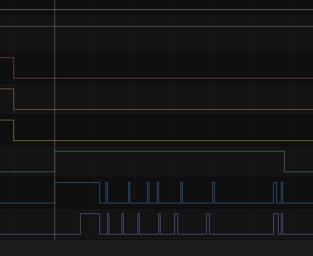

2021-07-20 1:34 PM
Appended trigger to TXen.
Nothing happen for a long time.
Pressed reset and released, one pulse is transmitted just after release. This time PHY is not ready...
Read errata about network issue on STM32F4x7, nothing appropriate and no mention of irresponsive network..
Actual setup
Edit1: traced both f407 and f429 code Ethernet register access not found. Someone know where MAC registe got accessed from?

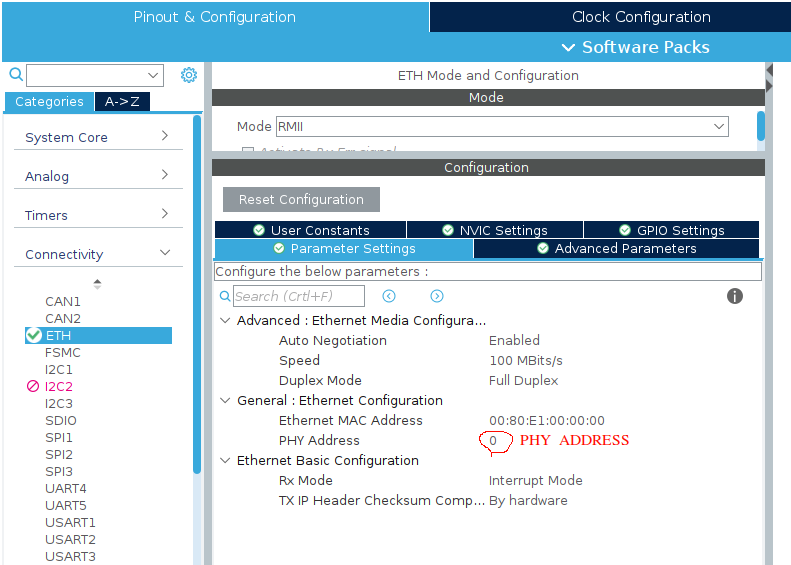

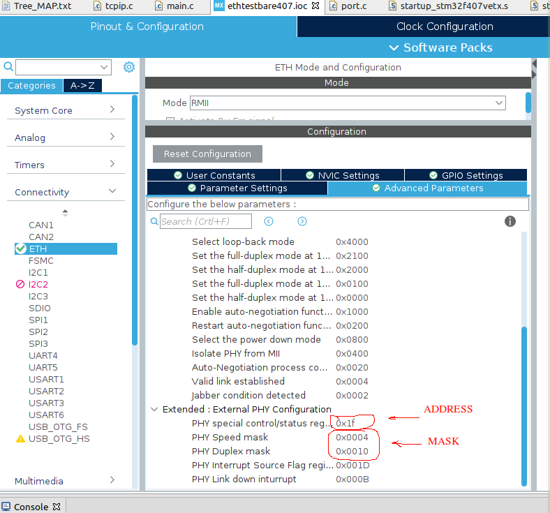

stm32f4xx_hal_eth
on lines 415-479 register 16 of phy is interpreted as autonegotiation result, register 16 or 0x10 is listed on datasheet as EDPD NLP/CROSSOVER TIMEREGISTER
nothing to do with remote party negotiation
Register carrying this information can be 31 or 0x1f PHY SPECIAL CONTROL/STATUS REGISTER
but format is different on list, anyway
bit 4 is duplex PHY_DUPLEX_STATUS must be 0x10 not 4
1 Full
0 Half
Bit 3,2 PHY_SPEED_STATUS is assigned value 2 odd but ok bit 3,2 value must be 4, 8, better to test for right value.
01 10 Base T
10 100 Base T
link task also carry on HORRIFIC goto too... Is this professional or not?

if((phyreg & PHY_DUPLEX_STATUS) != (uint32_t)RESET) <<-- // Mask must be 0x10 not 4 What mean RESET???
/* Set Ethernet duplex mode to Full-duplex following the auto-negotiation */
(heth->Init).DuplexMode = ETH_MODE_FULLDUPLEX;
else
/* Set Ethernet duplex mode to Half-duplex following the auto-negotiation */
(heth->Init).DuplexMode = ETH_MODE_HALFDUPLEX;
/* Configure the MAC with the speed fixed by the auto-negotiation process */
if((phyreg & PHY_SPEED_STATUS) == PHY_SPEED_STATUS) <<-- // this is worst, mask must be 0x0c and test vaue 4 10 base t or 8 100 Base T

HAL_ETH_ReadPHYRegister(&heth, PHY_SR, ®value); <<-- // register address required to be 0x1f not 0x10 !!!
/* Configure the MAC with the Duplex Mode fixed by the auto-negotiation process */
if((regvalue & PHY_DUPLEX_STATUS) != (uint32_t)RESET) <<-- // value must be 0x10 not 4
heth.Init.DuplexMode = ETH_MODE_FULLDUPLEX;
else
heth.Init.DuplexMode = ETH_MODE_HALFDUPLEX;
if(regvalue & PHY_SPEED_STATUS) <<-- // mask required to be 0x0c, test value 04 08, simple test here can be 04, good code test 04 08 and set error otherwise (Without goto possibly...)

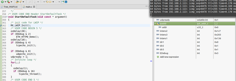

Added independent monochromatic blink led on hard fault loop never seen blink nor get solid color.
VCC 3.23V VCAP1=VCAP2 = 1.25V
Commenting out Network init code remaining task work fine.

F417, generating a new project:
patching PHY register address,
commenting out all network tasks other than LWIP_Init
got DHCP negotiation:
IP address after negotiation remain zero(??)
From router table got address, it respond to ping.

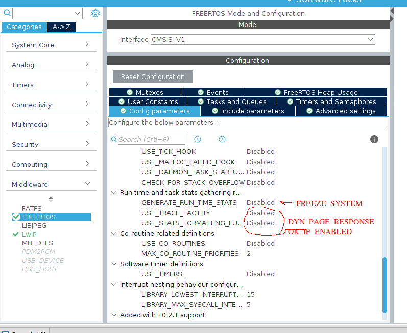

Enabled HTTPD, browser work on demo page loading quite fast but slow down a lot during file access.

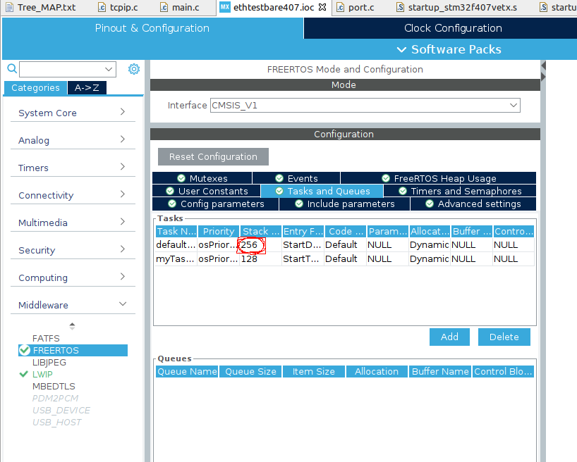

Enabling FreeRTOS config parameters:
USE_STATS_Formatting, USE_TRACE_FACILITY remain up and respond to dynamic page. (after patching stack space)
enabling GENERATE_RUN_TIME_STATS freeze all.
Default task 128Bytes stack is not enough, raised to 256 seems more stable.
One thing is now out: Hardware. At almost 417 one is ok. System is too much unstable and not usable on industrial environment.
Generated another base project targeted to 407VE, as is froze. Applied stack increment to default task respond to ping.

Updated Cubeide to new version 1.7.0:
many RTOS setting reverted to default, all parameter listed need be checked again.
New fresh project now respond to ping. PHY Address still set to 1 when all board use 0. Status register address still 0x10
Old project after restoring settings respond to ping but HTTP task is no more working. (Work in progress)

I think I've seen issues with hard faults in the past when the configured stack was too low. It's good to enable the stack overflow monitoring in freertos configuration. I would anyway increase the stack to e.g. 768 to have a bit of margin...

hello Sebastiaan, at first thank for support.
Hard fault is not fired as written thru text, system freeze and lost control, yes it resemble a stack failure.
Stack overflow monitor was enabled, not of help when mcu is freezed with no idea where it was freezed, so catched by single stepping code or dynamic modifying bit of an execution flag.
About working project, same code was working on F417, not working on F407 this time is HARD to get some new part to test. It work fine on F429Z nucleo board hosted.
Project is from February, prototypes never got at an usable level. Actually reworked to use an F750 or better H750 I use on another project. Till 2022 when we all hope silicon available again we have not so many choice than use what we have.
