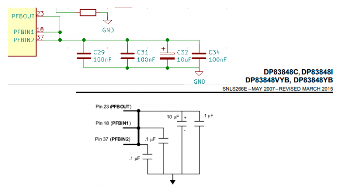

I have an STM32F407 and I'm using LwIP + DP83848 Ethernet PHY. I'm facing problems to ping the unit and I don't know why.

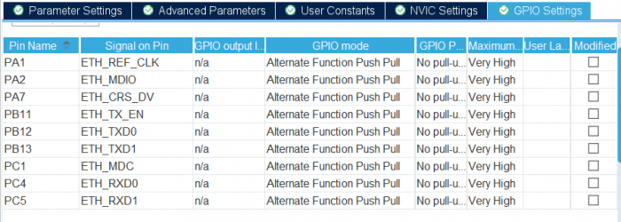

The pinouts for the RMII settings.

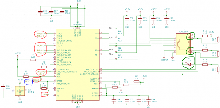

Red rings got to the processor. The blue ring shows RESET. It need to be logic 1 (HIGH) for the Ethernet PHY to start. The green ring shows a LED lamp that flashes when something happen on the internet cable e.g I ping an IP-address.

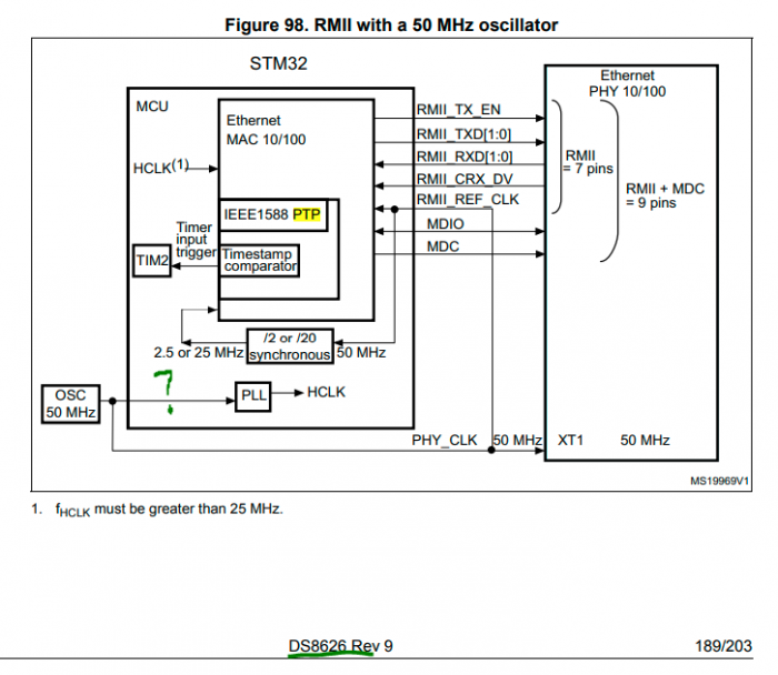

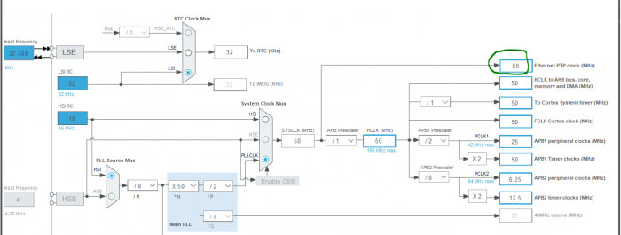

The oscillator is at 50 Mhz and I don't know why it should go inside my processor. This is from the datasheet DS8626 of the ST-microcontroller. https://www.st.com/resource/en/datasheet/dm00037051.pdf
I think this is OK to just write 50 MHz for Ethernet PTP?

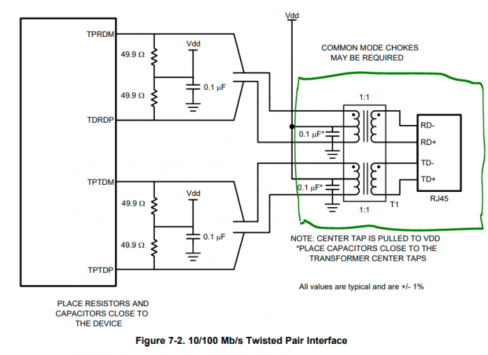

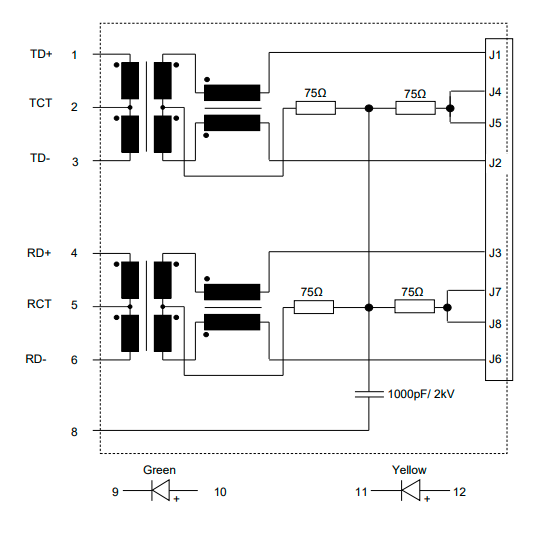

I have connected my RJ45 connector like this

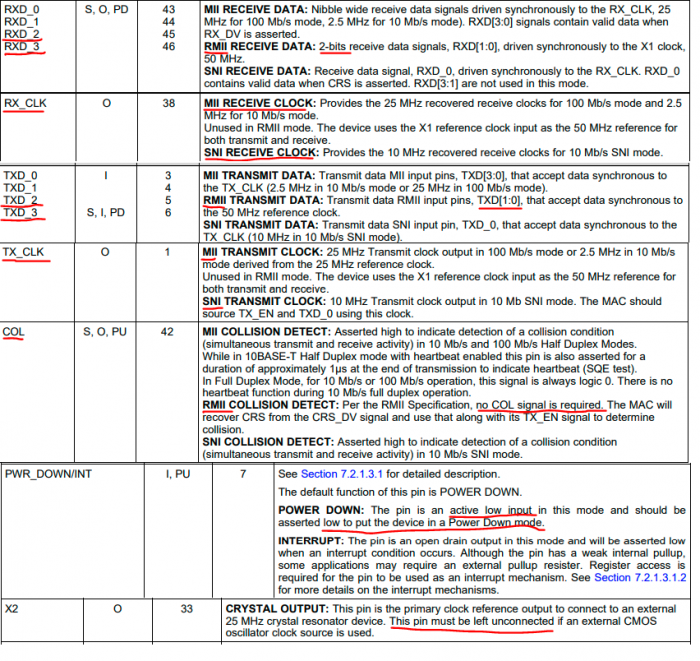

Other tiny pins of the Ethernet PHY
Pins that are not used are:
Special pinns:
https://i.stack.imgur.com/UszLt.png
Some pins have Pull-up and pull-down. I have pull-downs on all input pins of the ethernet PHY.

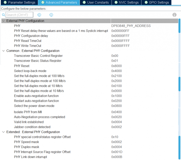

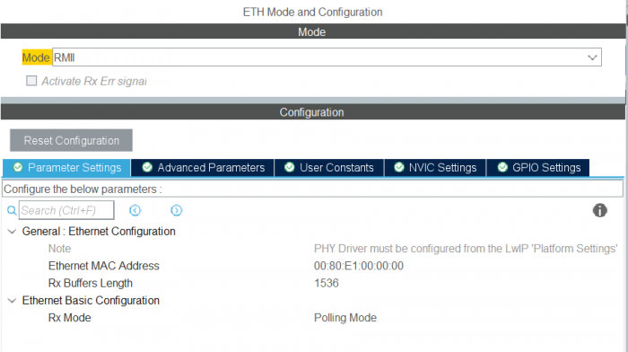

Last picture is the LwIP configuration. Were I select the IP address and the ram address at 0x20014000 with a size of 1600 bytes. My RAM address goes from 0x2000000 to 0x20020000 e.g 128 kB.
https://i.stack.imgur.com/dEliW.png
https://i.stack.imgur.com/HaCJR.png
