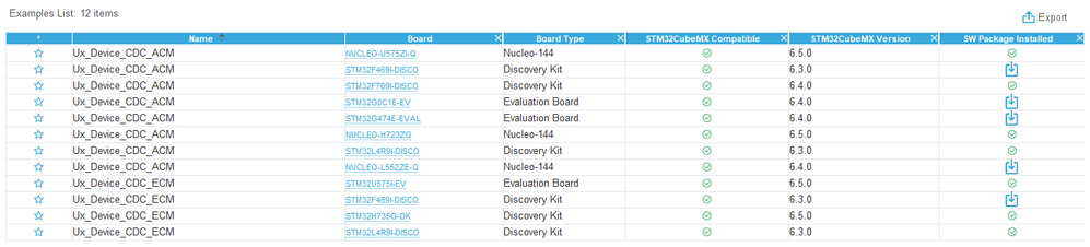

AZURE RTOS USB device CDC example is available in CubeIDE as shown in the figure below.
The example when used for the NUCLEO-U575ZI-Q, STM32L49I-DISCO and STM32F769I-DISCO boards provides the FS. You can follow one of these examples and when based on this article, you can define the compatibility of the example with the NUCLEO-H745ziq board.

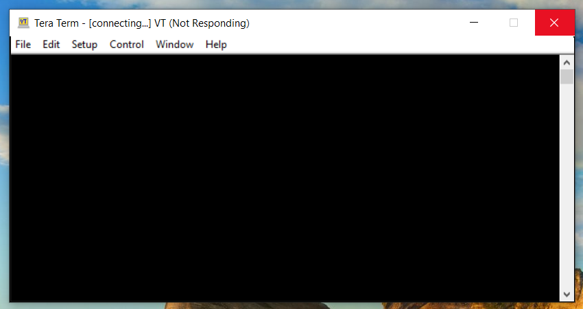

I try this example for Nucleo-H745ziq , the USB port is detected . In device manger i set the baudarete 115200 for usb and USART3 but when I try to open the port usb in Tera terminal is goes in not responding mode why these happen ? can you help me
