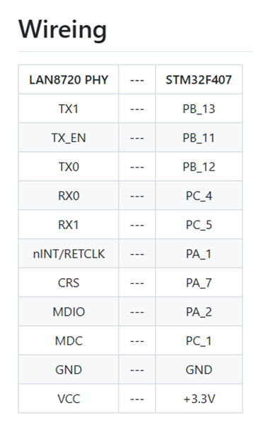

Hello colleagues,
Hope you may help me in one issue I'm facing w/.
What I have in hands:
int main(void)
/* USER CODE BEGIN 1 */
/* USER CODE END 1 */
HAL_Init();
/* USER CODE BEGIN Init */
/* USER CODE END Init */
SystemClock_Config();
/* USER CODE BEGIN SysInit */
/* USER CODE END SysInit */
MX_GPIO_Init();
MX_LWIP_Init();
MX_RTC_Init();
MX_USB_DEVICE_Init();
MX_CAN1_Init();
MX_SPI2_Init();
MX_I2C1_Init();
MX_SDIO_SD_Init();
MX_USART6_UART_Init();
MX_USART1_UART_Init();
MX_USART2_UART_Init();
MX_USART3_UART_Init();
MX_DAC_Init();
MX_FATFS_Init();
/* USER CODE BEGIN 2 */
Init_System(); // from proc_system.h
/* USER CODE END 2 */
/* Infinite loop */
/* USER CODE BEGIN WHILE */
while (1)
/* USER CODE END WHILE */
/* USER CODE BEGIN 3 */
main_whileX();
/* USER CODE END 3 */
So I build the FW and run it via discovery onboard STLINK in debug mode. Everything works fine, static IP is pinged, WEB server works. Than I disconnect USB cable of onboard STLINK (MCU as well as LAN8720 is unpowered) and than connect in back (MCU and LAN8720 are powered).
THE PROBLEM: ETH link is DOWN, IP is not pinged. However if FW is uploaded again via STLINK, once MCU is reset LINK is UP again.
Sounds like all is OK when LAN8720 is already powered (for some time?) when PHY is started to be configured on FW side via MX_LWIP_Init();
And all is BAD if MX_LWIP_Init(); is called immediately at power up (when STLINK USB cable is connected). I tried to add 1s delay before MX_LWIP_Init() but it doesn't help.
Would appreciate a lot for any clues. Thank you in advance!
