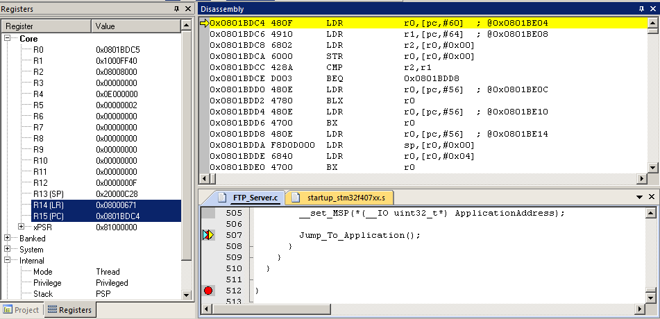

I corrected the length for both (bootloader and application). Verified base address for stack, but the problem still occur. Stack base address on bootloader is 0x20005418; Stack base address on application is 0x1000f540; Now when debugging enter in the if condition but doesn't jump to the application, I had put a break point on Jump_To_Application and registers as image attached, but I don't know why this error still occur. if (((*(__IO uint32_t*)ApplicationAddress) & 0x1FFE0000 ) == 0x10000000) { /* Jump to user application */ JumpAddress = *(__IO uint32_t*) (ApplicationAddress + 4); Jump_To_Application = (pFunction) JumpAddress; App_ptr = (uint8_t*)Jump_To_Application; if( (*App_ptr != 0xFF) && (App_ptr) ) { /* Initialise user application's Stack Pointer */ __set_MSP(*(__IO uint32_t*) ApplicationAddress); Jump_To_Application(); } } Thanks, Giovani ________________ Attachments : registers.png : https://st--c.eu10.content.force.com/sfc/dist/version/download/?oid=00Db0000000YtG6&ids=0680X000006I0ct&d=%2Fa%2F0X0000000bdK%2FUNfzFuHt6ljpO9IbGu78N6GDs4VPf_O.i9BMF46ezB4&asPdf=false2016-06-14 8:38 AM
The registers without the assembler code it is executing really isn't going to tell me much.
What is the ''error'', you need to step through the code, probably in disassembly mode, and understand what it is doing, and what checks are being made. You'll want to step from the loader, into the application, confirming it goes and does what you've coded.This test is backward if you want to check if the pointer is NULL, it does the test left-to-right, you should check for it being NULL before checking the values it is pointing too. if( (*App_ptr != 0xFF) && (App_ptr) )2016-06-14 11:59 AM

I don't know what is the error that occur because all seems to be correct. I tried to paste disassembly code in attachment. Thanks for your help again.Giovani
________________ Attachments : image_2.png : https://st--c.eu10.content.force.com/sfc/dist/version/download/?oid=00Db0000000YtG6&ids=0680X000006I0l9&d=%2Fa%2F0X0000000bdL%2FCC1YtjePWCF5qYGosc.y8thnXtUH0u1iCHkOD3LSB94&asPdf=falseimage.png : https://st--c.eu10.content.force.com/sfc/dist/version/download/?oid=00Db0000000YtG6&ids=0680X000006I0Tr&d=%2Fa%2F0X0000000bdJ%2FGKBJs6Dj5tWDbp1FjBtdrR5f1IZ.H1FygZCALpG6j.E&asPdf=false2016-06-14 1:27 PM
Ok, so it appears to have transferred control to the ResetHandler in the application, to some code that looks rather familiar

Check the value in R0, and confirm it is ODD (Thumb Code), and that it points to your SystemInit() function, typically in system_stm32f4xx.c
If you are using interrupts (SysTick, etc) in the Boot Loader, consider how they will be handled in the Application. An RTOS may also cause issues.2016-06-15 5:59 AM
Hello Clive!
I don't have interrupts neither RTOS on bootloader firmware. I just start clocks and bkp registers to verify if I need to download new firmware for the flash. On application firmware: Reset_Handler PROC EXPORT Reset_Handler [WEAK] IMPORT SystemInit IMPORT __main; LDR R0, =SystemInit BLX R0 // at this moment R0 is pointing to SystemInit (0x0801BD31) LDR R0, =__main BX R0 // at this moment R0 is pointing to main(0x08008189) after this goes to hardfault Thanks.2016-06-15 11:11 AM
