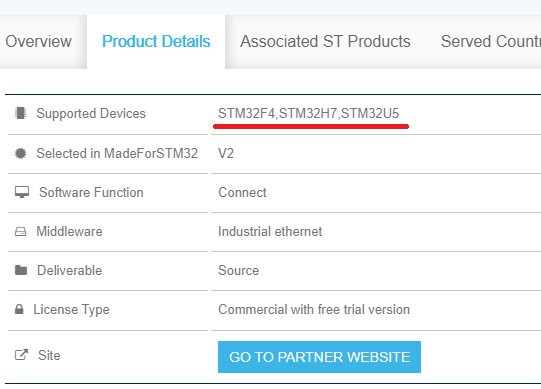

this, is an EtherNet/IP solution offered by our partner PortAutomation.
You need to contact them directly over this link
These are the supported devices:
Hope I answered your question. If it's the case please "Accept as Solution" my answer.

2024-05-22 5:14 AM
Are there any other solution for using EtherNet/IP with an STM32F4?
