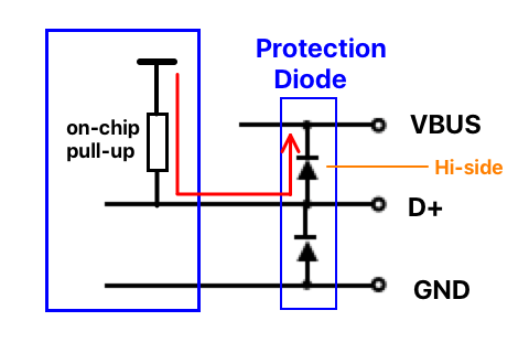

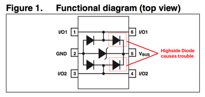

A couple of stack / hardware bugs disturb this operation.
A) CubeMX bug:
On Discovery board, with STMPS2141STR as USB host power switch, CubeMX generates bad initialization code, which supplies 5V rail to the VBUS pin. As the result, device can't detect plug off. Refer to
/public/STe2ecommunities/mcu/Lists/STM32Java/Flat.aspx?RootFolder=/public/STe2ecommunities/mcu/Lists/STM32Java/CubeMX%20bug%20USB%20devices%20wrongly%20enable%20host%20power%20switch%20on%20Discovery%20boards
. B) Wrong choice of protection diodes on USB lines If your board would mount protection diodes for D+/D- line with high-side diode, like USBLC6-2, the diode keeps VBUS voltage, passed by the D+ pull-up resister, after plug off. And then, VBUS drop isn't detected.We’re moving the ST Community to a new platform to give you a better and more reliable community experience.
