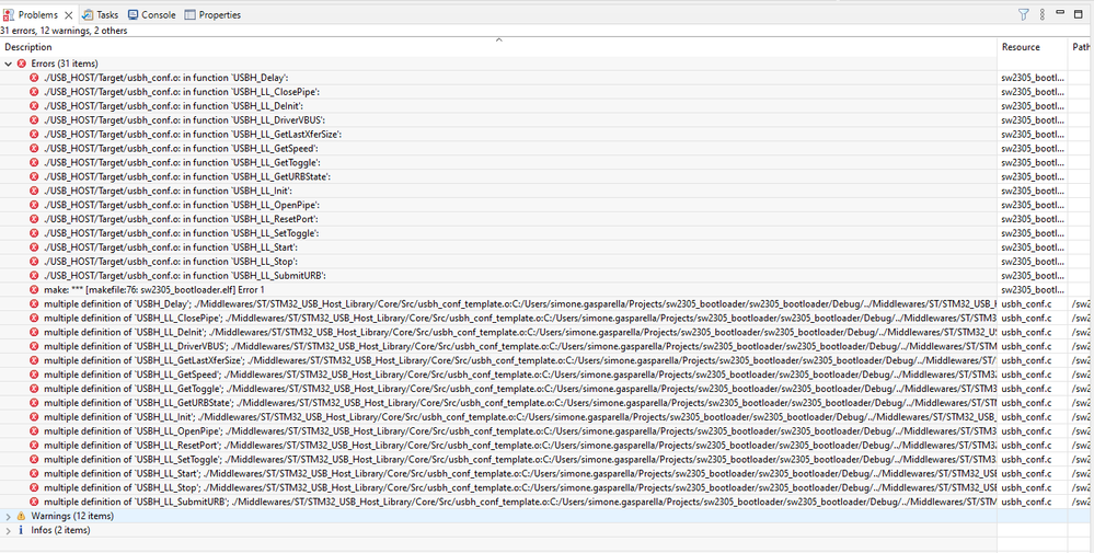

This is what i get only replacing the core directory and the msc directory
any suggestions?

May be you can analyze by yourself compile error. Try to catch and solve the first one in console.
Maybe you have to check how you are including headers.
Info and warning can help also. Don't focus only on error.
Sorry I tried to share what bug i managed to solve, but i can't work instead of you.
Just a Last tips: have you mixed HAL and LL?
Keep us informed, no doubt you can manage it!
