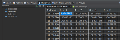

Yes, this is what you mentionet probably. 0x1ffff7e0  adress contains 0x80 value which says 128 in decimal. Is that what you mean ?
Altough, ı wrote data into 0x0803f800 and read it correctly. As we discussed above, ı have turned to use page 64 for make it guarantee.

Yes, as I said memory present on the die, not final tested to save time/money, and the usable/tested about written as a uint16_t word into system memory.
The valid page range 0-63 for 128KB device, not 64
