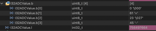

I am casting a Byte array (results from ADC) to a long, but occasionally - about 1:100000, it get the sums wrong. I've got to the line in the code where it goes wrong, and it is when it is casting a byte array to a long (I use union Method).

When I run the debugger, it is having too bit a blue in I32ADCValue.l - in fact where I set .b[0] to 0, it is not after it has cast it.....any clues?

Looks correct to me. 756497664 = 0x2D_17_3D_00. Those are the values in the array. Values are stored in little-endian format. Perhaps you are assuming big-endian, but then it would not be working ever, so it's unclear.

2024-01-02 9:40 AM
Ah, I found this not actually the problem. I checked the Big-Little Endian, and I had made an incorrect assumtion.
