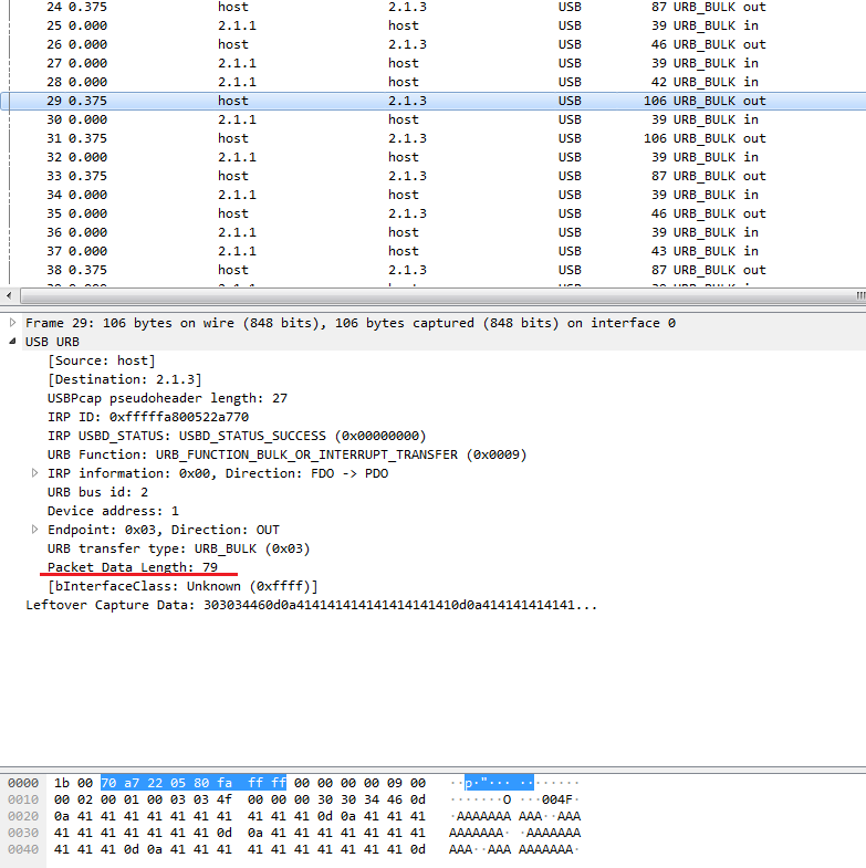

So, the issue is that everything works fine as long as the host sends packet of length no more than 64 bytes. But sometimes occasionally it decides to send more, for instance, 79 bytes:
And the STM responds with Receive_length = 64, i.e. it just cuts the data length resulting in data loss.

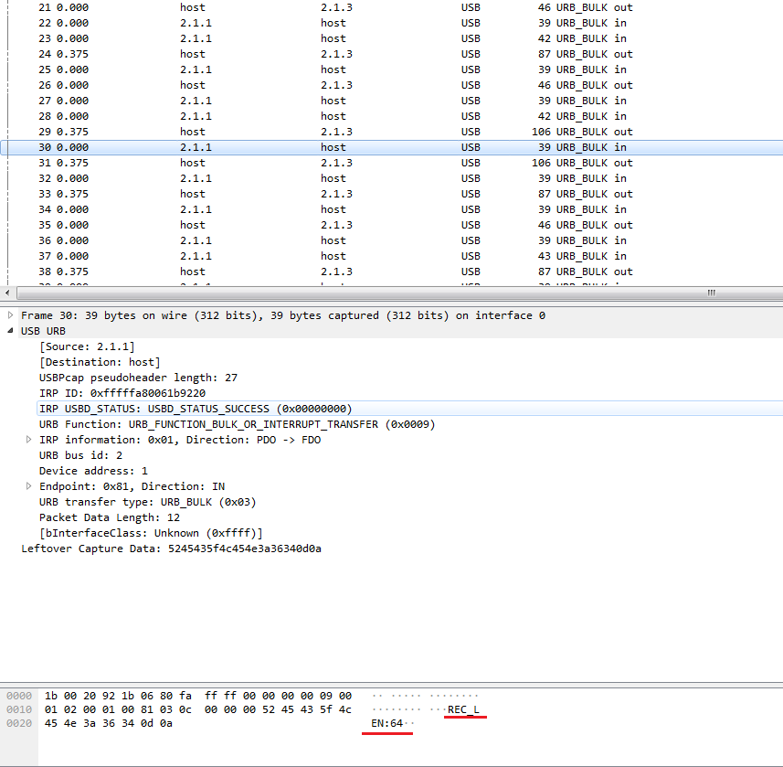

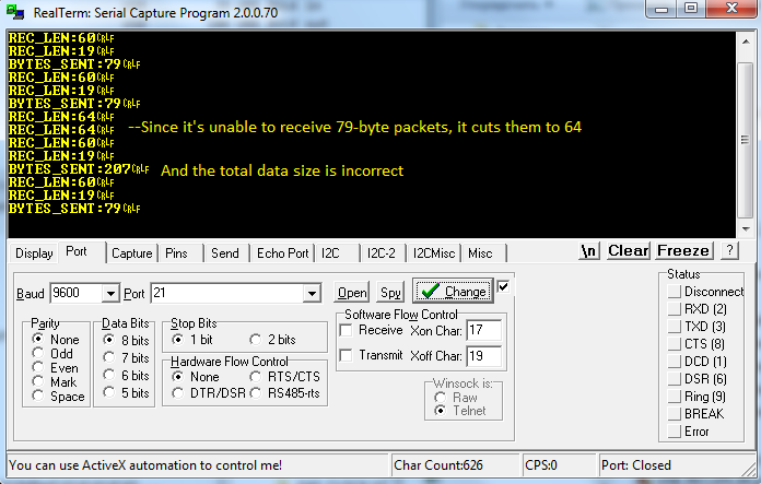

Here's what I see in the terminal:
I'm constantly sending a 79-byte file each 200 ms. Sometimes it works correctly, sometimes not.
