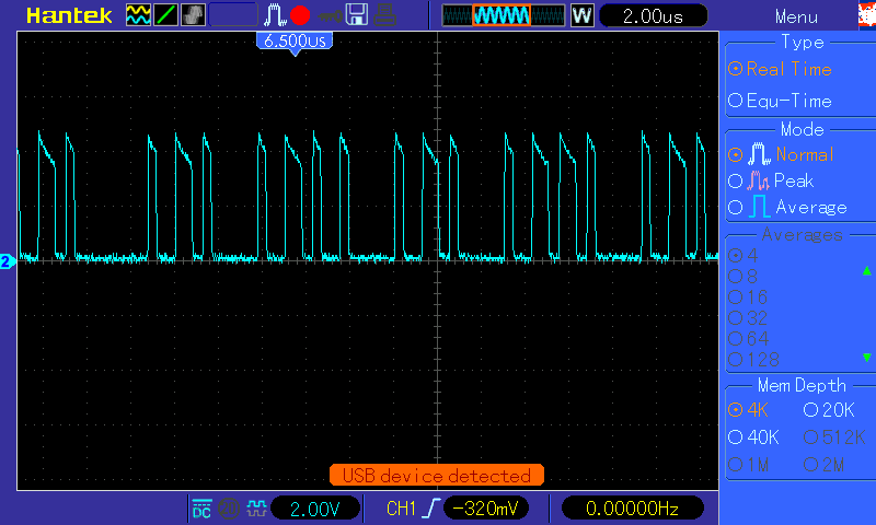

I'm try to generate some pulses to PB0 using STM32F103C8T6 with the following code

}I expect there to be only 3 pulses from the beginning to the end of the DMA buffer. However, when hooking to an oscilloscope, the pulses output are inconsistent.
Some pulses are right with short, long, and short pulses, but some pulses just have random long or short pulse in them. I can't see what's wrong with my code. Please let me know if there is anything potentially wrong with my code.

The DMA is pretty fast, but it isn't instantaneous. If it can't transfer the new compare value within a single TIM cycle (10 clocks in your case) the next cycle will re-use the stale compare value, resulting in a duplicate pulse.
I don't recall seeing a specification (for any STM32) for how many bus clocks a DMA transfer takes, but 6-10 is not unusual for other MCUs. Judging by the pattern in your trace I'm guessing it's about 12.
A quick experiment would be to slow down the timer by e.g. doubling the PSC (->(2-1)) to see if the symptom still appears.

Yes, putting (12 -1) to the auto reload register actually makes it much more stable and fixes the issue. Thank you very much.
