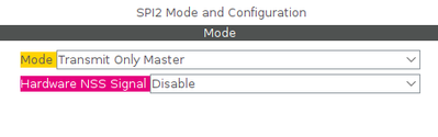

2024-02-15 5:26 AM - edited 2024-02-15 5:57 AM
Cannot be ... :flushed_face:
Show what you set in Cube to SPI2 . we looked already.
Try debug - on HAL_SPI_Transmit(...) : what it doing ???

2024-02-15 11:57 AM - edited 2024-02-15 12:02 PM
ok - just : you use cubeIDE - right ? nothing special doing .... ?
Because i set it in CubeMX, then generate code, then write to spi (HAL_... ) -- and it works.
So you must do something different...but i have no idea, what it could be.

you set : half duplex master .
try:

CS ist low -> correct.
I have tried transmit only master -> no
The problem is -> NO CLOCK.
NO CLOCK -> WILL NOT WORK.
