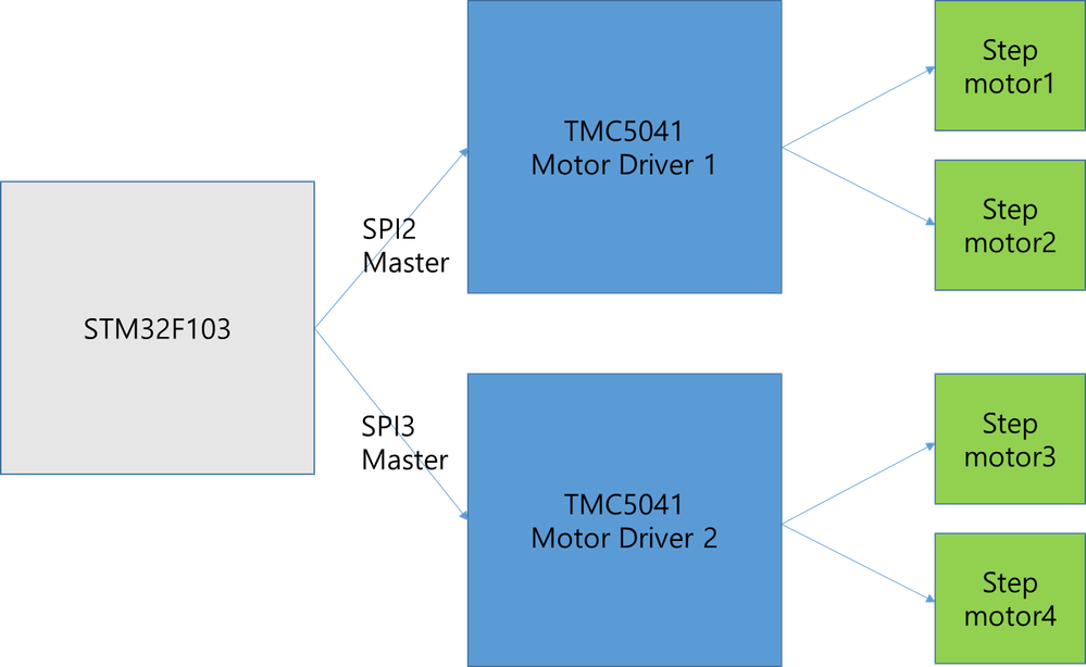

Hello, I am trying to control two Motor Drivers (TMC5041) through SPI communication using STM32F103. The compiler uses IAR. I am trying to communicate with two SPI Masters, but perhaps due to an initial configuration issue, only one SPI is controlled, so I am posting this to ask for help. The current progress was controllable when each SPI2 and SPI3 were controlled one by one. For example, control is possible when TMC5041 Motor Driver 1 is controlled without defining SPI2. Controllable when controlling TMC5041 Motor Driver 2 without defining SPI3 Therefore, it is judged that there is no problem with the communication protocol with each TMC5041. Here, when I try to use two SPIs 2 and 3 together, I am experiencing the problem that only one of the two SPIs can communicate and one is not communicating. In the process of specifying the initial configuration of two SPIs and sending and reading the data specified for each SPI, one SPI was able to write and read without a problem, and the other SPI was able to write data properly but not read. I'm asking this question because I'm wondering if it's a problem with the communication Initialize above.
