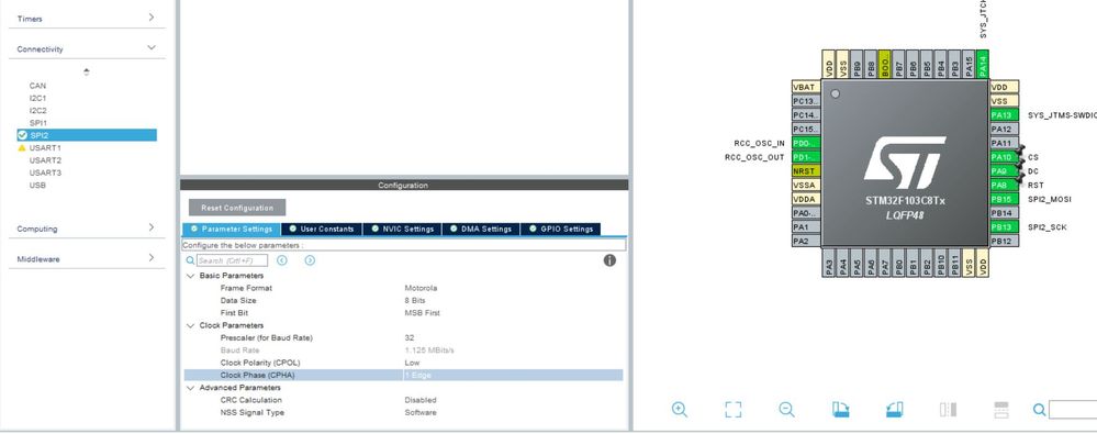

Then what is the problem
Here is how i configured the stm32f103 usnig STM32CubeMX:

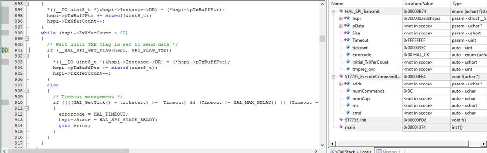

i have debugged it and found out that when goes into hal_spi_transmit() it initilaize every thing correct and when it try to transmit the data it chosses to transmit data in 8 bit mode (which is correct) it waits till TXE flag is set to send data, but goes to time out which means that TXE flag is not set (i think).
It keeps stuck there. I have tried to change RESET, CS and DC pins but without success.
