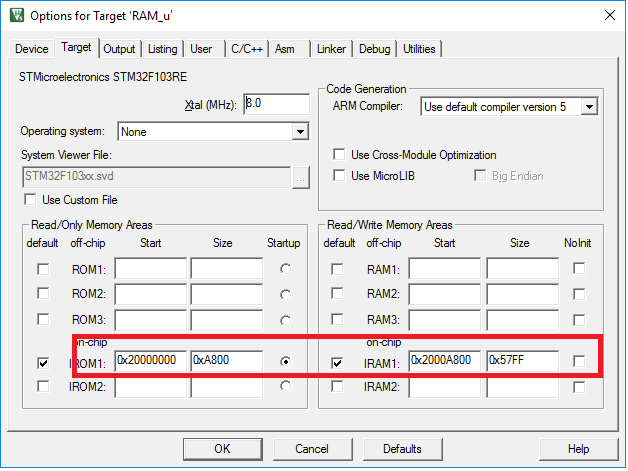

When i try startup my firmware from SRAM on stm32f103RE then nothing..
BOOT1 and BOOT0 is set to 1
Firmware developed on KEIL. Please, look my project settings:
int main(void){
__disable_irq ();
SCB->VTOR = 0x20000000U; __set_MSP(*((volatile uint32_t *) 0x20000000U)); __DSB (); __enable_irq();.....
init's and etc and main programm
1. I place my compiled firmware over ST-Link Utility on region 0x20000000 (upload dump and check it, all ok),
2. set BOOT1 & BOOT0 = 1,
3. and press RESET. Nothing! =( programm does not work (not blinked).. does not startup
why?
thank

If the part expects Reset_Handler to be at 0x200001E0 then it is not going to work if your build puts it at 0x20001234 or 0x2000120
Place ' DCD 0xF1E0F85F' at the end of the Vector table space, so it falls at 0x200001E0, to permit operation in this mode.

As discussed in other threads, over several years, the F1 has some special requirements with the placement of the Reset_Handler code. You will see 'BootRAM' in the GNU/GCC startup.s files for a given low, medium or high density parts. This is effectively a LDR PC,[0x20000004] instruction, but could just be your handler code.
Your main() function really doesn't have to do any of that. SCB->VTOR will be zero at reset, if SRAM is mapped at zero (and you can't change it on the F1, everything will be fine). Usually SCB->VTOR is set in SystemInit()
Look at STM32Cube_FW_F1_V1.6.1\Drivers\CMSIS\Device\ST\STM32F1xx\Source\Templates\gcc\startup_stm32f103xe.s
Attached (use Thread View) is a startup_stm32f103xe.s for Keil modified to permit RAM Booting

Cool!! it is worked!!
but i place
DCD 0xF1E0F85F with lead zeroes for align end of vector table in my startup
thank you, Clive for it magic
