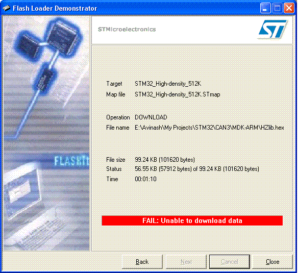

I am using PL2303 based USB to RS232 convertor. My Board has MAX3232 to USART1 interface. The ''ST Flash Loader Demonstration'' is working ok till last phase, where it fails after certain percentage of write. See the attached image ...2012-01-08 7:16 AM
Well that will be fun to trouble-shoot.
It is possible that the flash memory is a problem, which could be due to power supply issues. Look at the bulk capacitance on the STM32, and those on the MAX3232. Is the problem consistent across a number of boards? Different PCs or serial ports? It could be a communication problem, serial data transmitted in this fashion can get corrupted. Try lower baud rates, and perhaps two stop bits. The protocol does provide for some simple checksum integrity check, but I can't speak to the robustness of the retries, or page erase/retry capabilities of the flash loader demonstration. Most of the failures are probably hard, and the diagnostic messages non-specific. This might be easier to diagnose by using the command line source code, or reimplementing the protocol, so you can specifically identify if the problem is with transmission of data to the part, or the programming of data to the flash memory, or subsequent read-back verification.2012-01-14 10:48 PM
