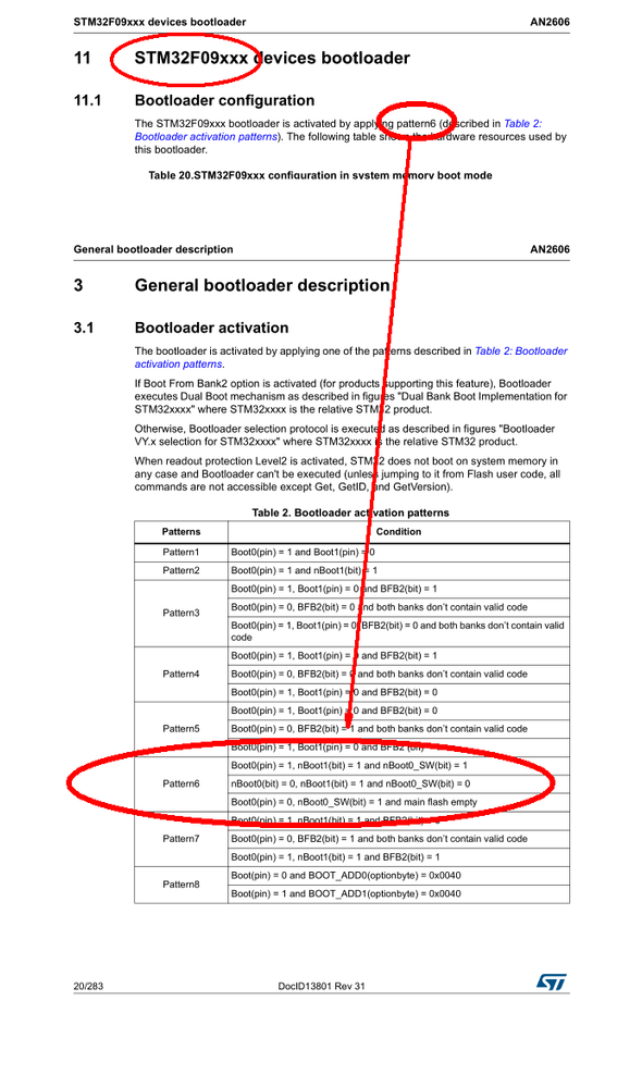

I check the AN2606, BOOT0(pin) =1 and BOOT1(Pin) =0 will go to bootloader, but there is no Boot1 pin in STM32F091 MCU.
How can go to bootloader mode?
I check DM00031936, BOOT0(pin) = 1 and nBOOT1 bit = 1 will go to bootloader, but how can I set nBOOT1?

> then nothing to UART after timeout, it will go to our application flash memory.
No, there is no timeout in the bootloader. Once enters bootloader, it will remain in it waiting, until either you connect using one of the programming methods (where there may be a command to exit), or until reset.
But there's no BOOT1(Pin) =0 in AN2606 either:
Using a programmer, such as STLink.
