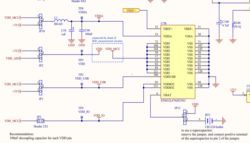

@Scott Dev : "Is there any issues simply using a 5v -> 3.3v regulator from eh 5v line of the input of the usb and powering the VDDUSB and the chips VDD all at the same time?"
-> Yes, this is possible and also implemented on our eval board.
Khouloud.
2018-09-19 9:57 AM
Thanks for the diagram.:)
Scott
2018-09-20 1:12 AM
You're welcome!
Khouloud.
