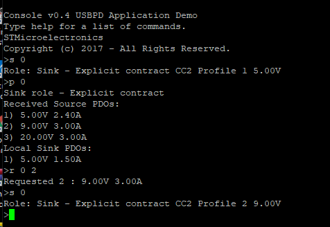

PNUCLEO_USB001-DEMO1.bin result
it identifies the source(usb pd capable psu). The yellow waveform is VBus others are cc
successful transaction from 5V - 9V

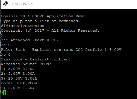

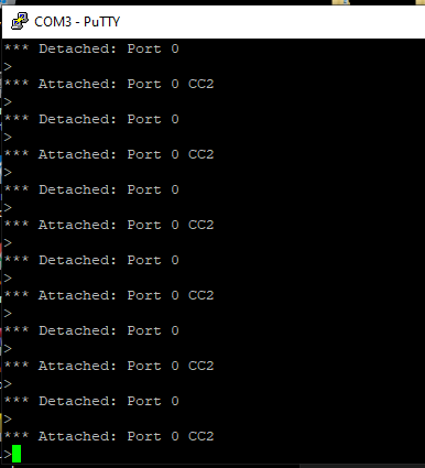

Consumer(Consumer_CLI_RTOS) example code result
here, it looks like it is trying to establish connection to the source but couldn't.
here is the waveform.
What could be the problem here?
