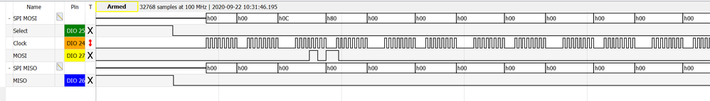

There is, however, one slight bugbear that I can't seem to explain or overcome. Straight after the STM32F072RB is reset the SCK signal is held high (implying a high idle state), however I have set my SPI up to communicate using MODE 0, i.e. low idle state, and sample on the rising edge. This high idle state causes the first received data to be left-shifted by 1 bit, as the first transition the clock performs, after the SS is asserted, is falling edge indicating the data to change for the subsequent rising edge. All transactions after this first are correct.
This is incorrect behaviour, and SCK should idle low at all times. I have tried pulling the GPIO low before setting it up as an alternate function pin, pulling it low afterwards, applying pull-up/pull-down resistors to no avail. (Although I should note that the pull up/down resistors would never have worked, as the slave chip has a pull-up resistor on its input!). My assumption is the pull-up resistor on the slave chip is interfering with the SS signal, but why it only occurs on start-up I am unsure of.
I have come up with a somewhat janky fix, by which I call an SPI transmit without asserting the SS signal. This causes SCK to cycle without sending any data, after which SCK correctly idles low, seemingly indefinitely. See my code snippets and logical analyser output below:

Logical waveform showing high clock idle (first transaction after reset):

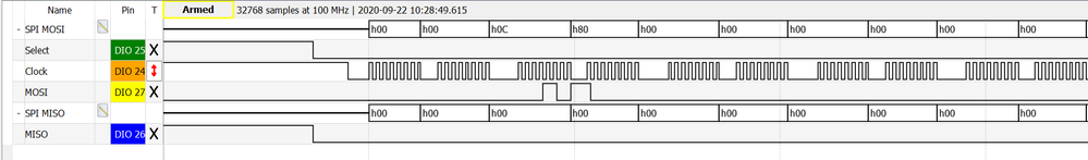

Logical waveform showing low clock idle (every subsequent transaction):

The clock isnt output until SPE=1, which doesnt happen in hal_spi_init.
When you call transmit, it sets spe=1 and enables the clock output.
4 REPLIES 4
After reset, your pin isn't initialized anymore and is in high-z input mode. If you need it to reflect a certain state, you'll need to add an external pullup/down resistor to enforce that.
Initializing and enabling SPI before asserting CS low also works.
