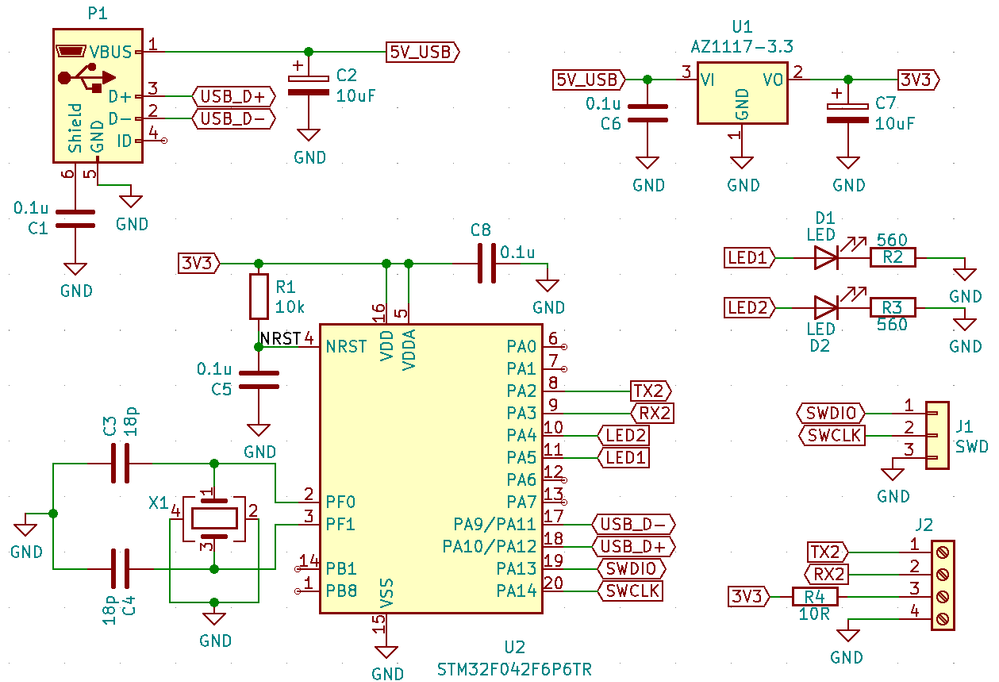

I design a custom USB - UART using STM32F042F6
This is my schematic

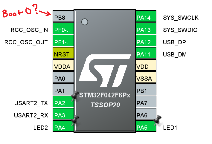

This is pin configuration in Cube MX

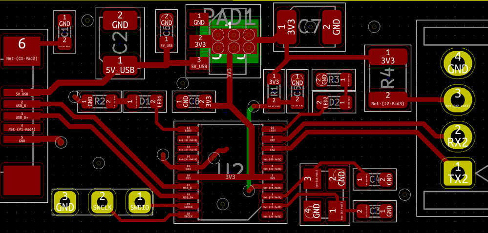

This is the board layout

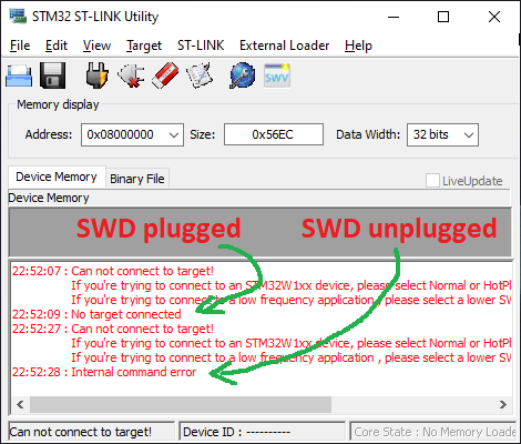

I tried STLINK Utility to just connect to the device in attempt to flash the program, it failed
I tried combination of speeds and MCU reset options but nothing worked.

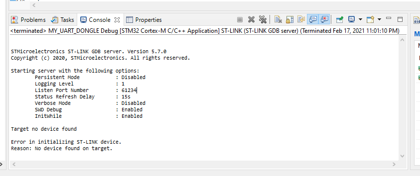

When I tried to flash the fw directly from STM32CubeIDE
I even tried DfuSe Demo tool to force the MCU to leave DFU mode but still couldn't connect to SWD.

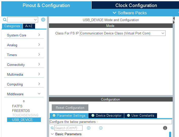

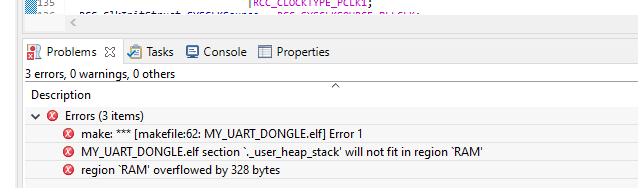

The second problem is when I change the USB device type in cubeMX into "Virtual Com Port"
It became overflowed.
When turned on USART2 in cubeMX, now the flash became too big as well.
This STM32F042F6 has 6k of ram and 32k of flash.

For now I am able to get a simple app to toggle 2 LEDs on my board and upload the program over DFU.
Pin#1 or PB8 does act as BOOT0. Set to LOW to run user application, and HIGH to run built-in bootloader (auto run DFU mode when USB detected)
Still unable to debug or program this MCU via SWD.
