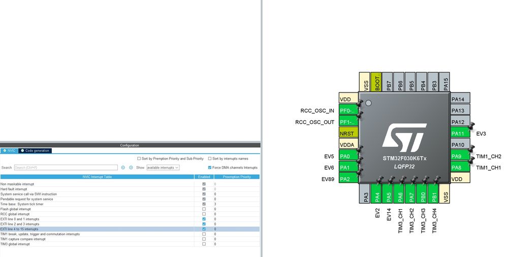

I try to use 6 external interrupts but only EXT4_15 is functionning. All is functionning correctly when i use HAL_GPIO_ReadPin() function without interrupts.
Thank you for your HELP
void EXTI0_1_IRQHandler(void)
/* USER CODE BEGIN EXTI0_1_IRQn 0 */
/* USER CODE END EXTI0_1_IRQn 0 */
HAL_GPIO_EXTI_IRQHandler(EV5_Pin);
HAL_GPIO_EXTI_IRQHandler(EV6_Pin);
/* USER CODE BEGIN EXTI0_1_IRQn 1 */
/* USER CODE END EXTI0_1_IRQn 1 */
* @brief This function handles EXTI line 2 and 3 interrupts.
void EXTI2_3_IRQHandler(void)
/* USER CODE BEGIN EXTI2_3_IRQn 0 */
/* USER CODE END EXTI2_3_IRQn 0 */
HAL_GPIO_EXTI_IRQHandler(EV89_Pin);
/* USER CODE BEGIN EXTI2_3_IRQn 1 */
/* USER CODE END EXTI2_3_IRQn 1 */
* @brief This function handles EXTI line 4 to 15 interrupts.
void EXTI4_15_IRQHandler(void)
/* USER CODE BEGIN EXTI4_15_IRQn 0 */
/* USER CODE END EXTI4_15_IRQn 0 */
HAL_GPIO_EXTI_IRQHandler(EV2_Pin);
HAL_GPIO_EXTI_IRQHandler(EV14_Pin);
HAL_GPIO_EXTI_IRQHandler(EV3_Pin);
/* USER CODE BEGIN EXTI4_15_IRQn 1 */
/* USER CODE END EXTI4_15_IRQn 1 */
}The main.c with the callback function

void HAL_GPIO_EXTI_Callback(uint16_t GPIO_Pin) {
switch(GPIO_Pin)
/*EV14*/
case EV14_Pin :
if (!HAL_GPIO_ReadPin(GPIOA, EV14_Pin)) {
cons_EV14_active = 1;
TIM1->CCR2 = CRR_spike;
t14 = HAL_GetTick();
} else {
cons_EV14_active = 0;
TIM1->CCR2 = 0;
break;
/*EV2*/
case EV2_Pin :
if (!HAL_GPIO_ReadPin(GPIOA, EV2_Pin)) {
cons_EV2_active = 1;
TIM1->CCR1 = CRR_spike;
t2 = HAL_GetTick();
} else {
cons_EV2_active = 0;
TIM1->CCR1 = 0;
break;
/*EV3*/
case EV3_Pin :
if (!HAL_GPIO_ReadPin(GPIOA, EV3_Pin)) {
cons_EV3_active = 1;
TIM3->CCR2 = CRR_spike;
t3 = HAL_GetTick();
} else {
cons_EV3_active = 0;
TIM3->CCR2 = 0;
break;
/*EV89*/
case EV89_Pin :
if (!HAL_GPIO_ReadPin(GPIOA, EV89_Pin)) {
cons_EV89_active = 1;
TIM3->CCR1 = CRR_spike;
t89 = HAL_GetTick();
} else {
cons_EV89_active = 0;
TIM3->CCR1 = 0;
break;
/*EV5*/
case EV5_Pin :
if (!HAL_GPIO_ReadPin(GPIOA, EV5_Pin)) {
cons_EV5_active = 1;
TIM3->CCR4 = CRR_spike;
t5 = HAL_GetTick();
} else {
cons_EV5_active = 0;
TIM3->CCR4 = 0;
break;
/*EV6*/
case EV6_Pin :
if (!HAL_GPIO_ReadPin(GPIOA, EV6_Pin)) {
cons_EV6_active = 1;
TIM3->CCR3 = CRR_spike;
t6 = HAL_GetTick();
} else {
cons_EV6_active = 0;
TIM3->CCR3 = 0;
break;

/* GPIO Ports Clock Enable */
__HAL_RCC_GPIOF_CLK_ENABLE();
__HAL_RCC_GPIOA_CLK_ENABLE();
__HAL_RCC_GPIOB_CLK_ENABLE();
/*Configure GPIO pins : PA1 PA2 PA4 PA5
PA11 */
GPIO_InitStruct.Pin = GPIO_PIN_1|GPIO_PIN_2|GPIO_PIN_4|GPIO_PIN_5
|GPIO_PIN_11;
GPIO_InitStruct.Mode = GPIO_MODE_IT_RISING_FALLING;
GPIO_InitStruct.Pull = GPIO_PULLUP;
/* EXTI interrupt init*/

1. [Part Number] STM32F030K6T6
2. [Environment] STM32cubemx6.14.1 + STM32CubeIDE Version: 1.18.03.
3. [Schematics] See the screenchot above. It's custum board. All is functionning correctly when i use HAL_GPIO_ReadPin() function without interrupts.
4. [Details] only EXT4_15 is functionning.
5. [Expected behavior] all external interrupts needs to be OK
6. [How to reproduce] Inputs are configured with pull-up resistor and Rising/Falling edge detection
2025-07-16 4:43 AM
I've done a quick test. It seems to be the good way : now all is functionning except EV5 (PA0_Pin). I will do more verification tomorow.
Thank you
2025-07-16 4:59 AM
@Johan_mecatronique wrote:3. [Schematics] See the screenchot above. It's custum board.
That's not a schematic - that's just the CubeMX pinout.
That tells us nothing about the external hardware & connections.
You need to show the schematic of your board - ie how the STM32 is connected to the rest of your system.
