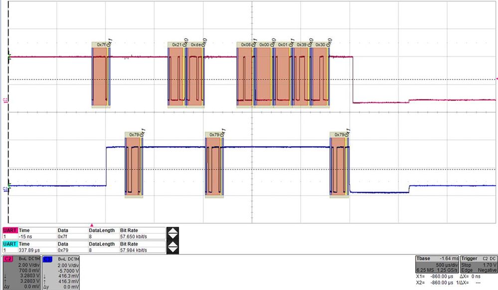

But when I try to start the application via the bootloader putting the Boot0 pin to VCC. I can not get it running.Here is a figure how far I come with bootloader.
I talk with the bootloader via Uart and erverything is accepted but I fail to provide the right flashaddress to start the application. I thought it should be the address of the reset handler which is 0x08000139. Do I miss something here or is the approach correct ?
