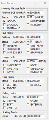

2025-07-30 12:41 AM - edited 2025-07-30 12:43 AM
Hi again! I wasn't expecting to have answer that fast !
First thanks to you three, those comment help reduce the search area.
So first, my code who is next is effectively not reach (verify by the use of bp), and now i have conclude that, if i comment adc read, everything break, and if i comment it everything is okay.
Everything break: Meaning any loop and especially the loop in HAL_Delay() make the program hardfault.
void adc_measure(uint16_t channel, uint8_t *result)
measureInProgress = true;
adc_init(channel);
HAL_TIM_Base_Start_IT(&htim2);
while (measureInProgress)
if (measure_pending_count > 0)
adc_read();
__disable_irq(); // Prevent race condition
measure_pending_count--;
__enable_irq();
measure_pending_count = 0;
HAL_ADC_Stop(&hadc1);
float measure = adc_compute_value(channel); // convert the value toward needed unit (mA or V)
snprintf((char *)result, RESULT_PRECISION, "%f", measure);
}Here is the fault report, register, and dissasembly code of when the crash happen
I also attach the entire "adc_driver.c/.h" file where the bug seem to take place.
Also i feel its important to precise that this function if call, is nested in multiple function call (5).
My english isn't perfect because its not my mother tongue and i'm very new to embedded system. So i'm maybe missing a key component.

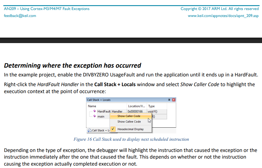

2025-07-30 1:35 AM - edited 2025-07-30 1:37 AM
STM32CubeIDE gives you a call tree showing where the fault occurred - can Keil do that?
If it turns out that the location is consistent, then set a breakpoint just before that point to see what's happening...
PS:
Yes, it seems that it can:
https://www.keil.com/appnotes/files/apnt209.pdf#page=17

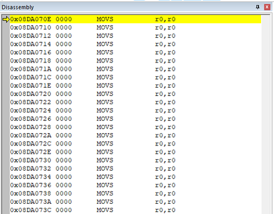

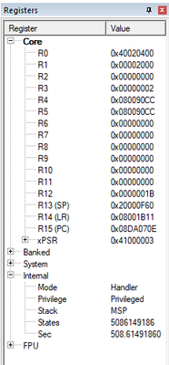

2025-07-30 1:44 AM
Thank for the tips.
It if i use this technique here is what i get :
It seems like the program go out of memory bound, i dont get how commenting a file change the issue of that.
