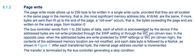

If you know, to write 2 or more bytes, you should not use "byte write", but page write, to do it in one access:
-> less stress to the eeprom and to you (about timing) .
2024-04-06 3:30 PM
Thank you. Of course I combine writes to consecutive addresses into page-writes, but when this address range spans several pages, I have to split it into multiple page writes.
