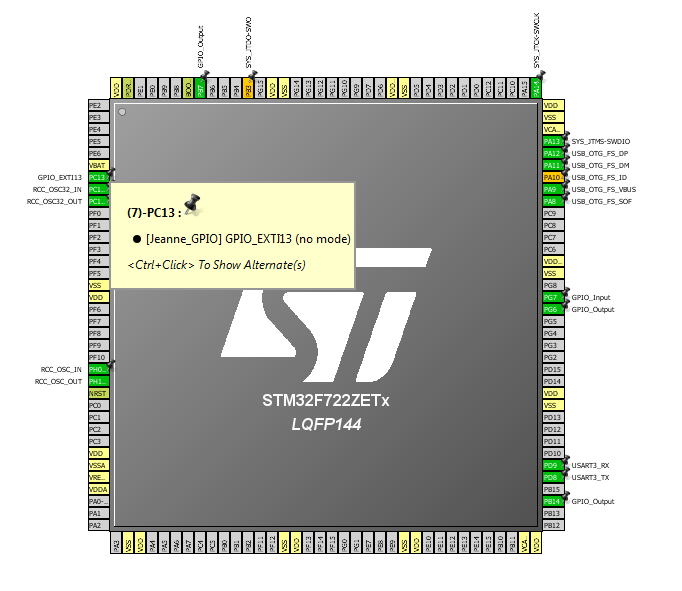

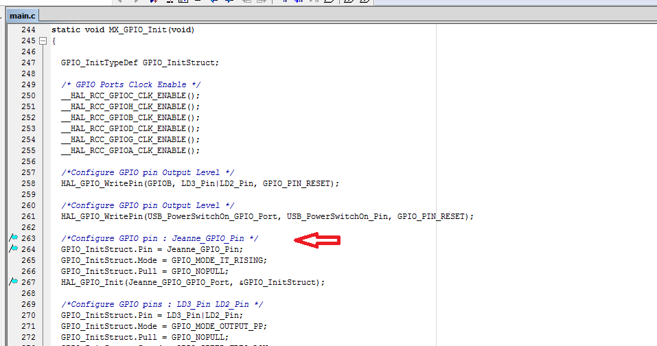

, indeed, user labels are correctly generated. Here, I took an example of STM32F722ZETX with the pin PC13 named Jeanne_GPIO as below :and after generating the code, I can find this user label in the main.c in the GPIO configuration part :
I think that fully answered the initial topic.

I find my user defined names ♯ defined in main.h
