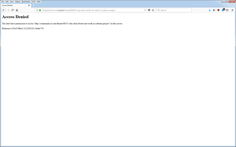

This post is a continuation of one I made a couple of weeks back but that post seems to be corrupted as it keeps crashing the web server with a 409 permissions issue.

This post flags up a red line, and when I first clicked on the thread it locked me out of two browser sessions, with an 'Access Denied' message. Something weird with your account metadata me thinks.
