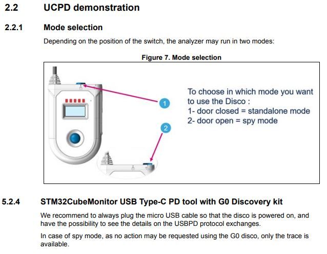

2020-08-24 8:46 AM
Hello Asmi,
Have you checked the UM2546 (STM32G071B-Disco USB-C Discovery kit) ?
Are you in standalone mode or in spy mode ? What is your door position ?
As indicated in the UM, when you are in spy mode (chapter 5.2.4) , only the trace is available, so you can't "see" the board.
See the wiki to see how to get the trace.
2020-08-24 2:42 PM
Thanks Nicolas! It turned out I didn't really understand how GUI is supposed to work. It works just fine now!
