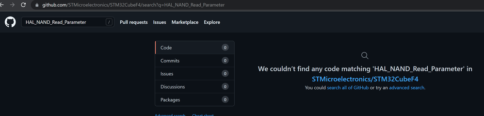

2022-03-15 8:50 AM
Those changes are not in the GitHub repo, or anywhere else on GitHub.
As for why not everything makes it into the release notes, that's just the way it is and always has been. I would recommend doing a diff whenever you upgrade and upgrade only when necessary and not simply when it's available.
