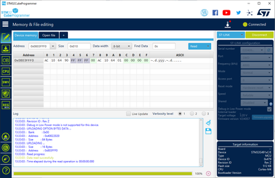

I'm trying to write some data to a address in the flash memory of the above mentioned chip. However the Erase doesn't seem to work.

And when do a full chip erase via STM32Cube Programmer, the writing to the flash works. But when I try to do it with some data storage already in the memory. It doesn't. Please help, I've been struggling now for a couple of days.

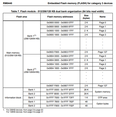

Hello @BAdmi.1,
You are using a G491RC with 256KBytes of Flash size in single bank only.
Dual bank is supported on devices STM32G4x3 Series.

Try just erasing in the program, nothing else; and then read out the erased area using CubeProgrammer - was it erased?
2024-01-03 4:35 AM
Not when i try it in the second bank, when i run the program for the last page of the first bank. It works just fine:

Changing banks value to 0x02 doesn't work. But why?

Hello @BAdmi.1,
