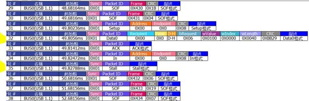

I use same operator to genertor example code of USB HID/CDC...etc. on different HW baord.1. STM32F303VC for STM32F3DISCOVERY
2. STM32F302CC for My target board DISCOVERY is okay, my target board is unknown device. On USB handshake, device report Stall. Then I use STM32_USB-FS-Device_Lib_V4.0.0 to complier and test. It's success. I suppose my HW is good. I don't why STM32CubeF3 is okay for STM32F303VC, but fail in STM32F302CC. Please help and give advice, Thany you very much. #stm32cube32015-05-17 6:54 PM

I fixed the problem that is cube bug.
the stm32f3xx_hal_pcd_ex.c didn't defined(STM32F302xC) Thank you.We’re moving the ST Community to a new platform to give you a better and more reliable community experience.
