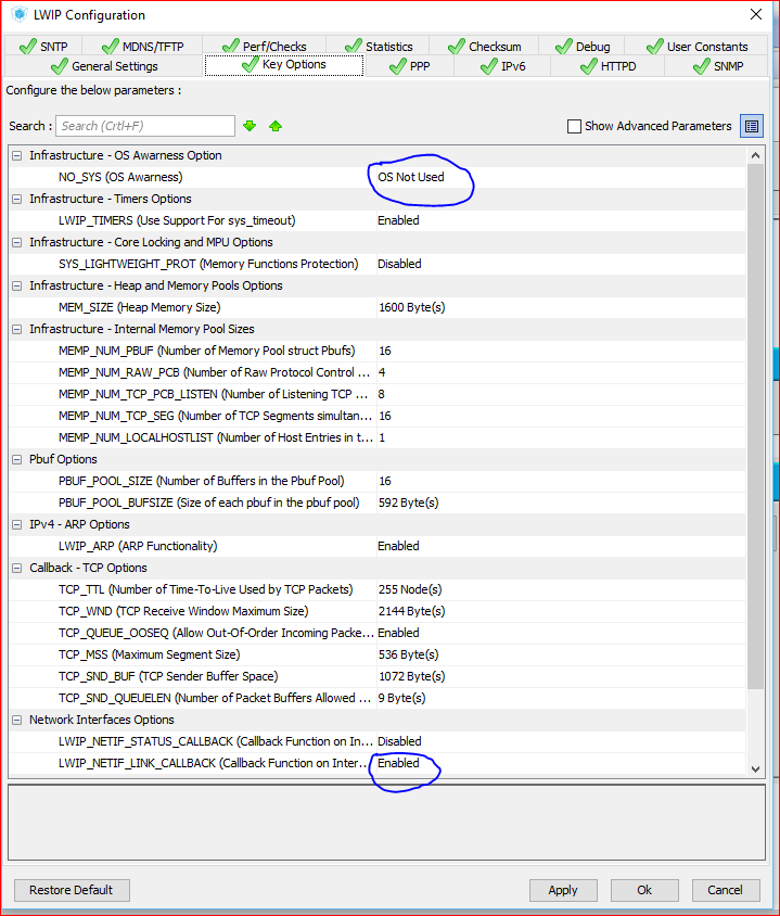

i have found a bug in STM32Cube V4.21.0.
I use the STM32F429BITx
When i select the following settings the generated code have some RTOS functions.
Please fix it.

You are right and this bug will be fixed in next STM32Cube V4.22.0 release.
2017-07-04 2:44 AM
The solution for you is to directly patch the following ftl file:
C:\Program Files\STMicroelectronics\STM32Cube\STM32CubeMX\db\templates\lwip_c_f2f4f7h7.ftl
Line 548: replace [#if series != 'stm32h7'] by
[#if (series != 'stm32h7') && (with_rtos == 1)]
Then generate again the code and it will be ok.
