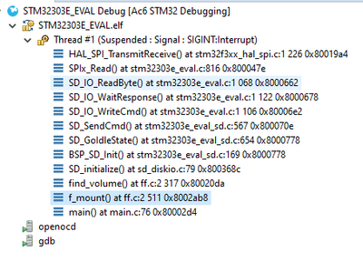

So I started over from scratch, installed AC6, opened the project, flashed it, started a debug session, and I get stuck in f_mount().

2026-02-09 1:16 AM
To be more precise, the code loops on:
/*----------Activates the card initialization process-----------*/
/* Send CMD1 (Activates the card process) until response equal to 0x0 and
Wait for no error Response (R1 Format) equal to 0x00 */
while (SD_SendCmd(SD_CMD_SEND_OP_COND, 0, 0xFF, SD_RESPONSE_NO_ERROR) != MSD_OK);in stm32303e_eval_sd.c
