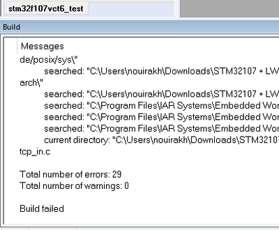

I have tested the project you have attached. I found this compilation error
"Fatal Error[Pe1696]: cannot open source file "reent.h"
Also, In the CubeMX configurations you need to replace this parameter "FREERTOS$context:USE_NEWLIB_REENTRANT" by 1, This configuration solves the problem.
