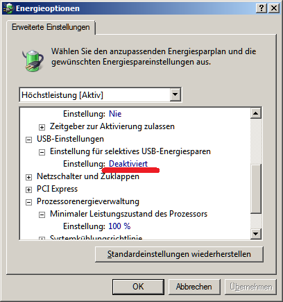

2019-10-07 11:50 PM
There is an option to disallow the OS from putting the USB device to sleep. Disabling this option has resolved some blue screen issues for me. It's not clear if it was an OS issue, a driver issue, or a hardware issue. Google USB Selective Suspend. Might be worth a shot.
2019-10-08 1:24 AM
Hi TDK,
I think, we can exclude this. I have done this as first after installing the OS: Disable all Energy save options and put all other options to 100% performance. One part of this is also to disable selective USB suspend.
Knut
