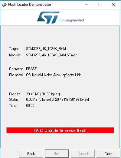

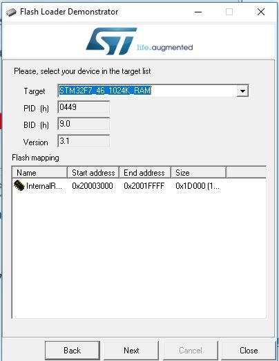

I am going to program qspi flash using UART boatloader that can use for future update from internet,
My MCU is STM32F746BG, I change sample project of AN2606 and make new .bin file. but i can not program RAM of stm32f746 using flash loader.
i get Error: can not erase or can not download.
I change .STmap file for my MCU:
[Product]
Name=STM32F7_46_1024KPID=0449BID=1FF0EDBEFlashSize=0400 ;;ADDR_FLASH_SIZE=FFFFFFFF; TO BE DONE !!!!PacketSize=80ACKVAL=79MAPNAME=SectorsPagesPerSector=1family = 6;;; InternalRAM[InternalRAM]Name=userRAMAddress=20003000Size=0001D000Type=111UFO=111;;---------
what is wrong?
2017-06-22 2:28 AM
Hi, problem resolved.
I change STMap file as:
[Product]
Name=STM32F7_46_1024K_RAMPID=0449BID=1FF0EDBEFlashSize=0400 ;;ADDR_FLASH_SIZE=FFFFFFFF; TO BE DONE !!!!PacketSize=80ACKVAL=79MAPNAME=SectorsPagesPerSector=1family = 6;;; InternalRAM[InternalRAM]Name=userRAMAddress=20010000
Size=0001D000Type=111UFO=1112018-09-17 4:55 AM
