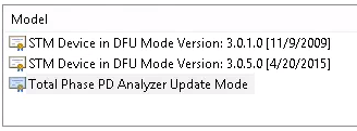

When I put my STM32F4 device into DFU mode, it is recognized as a ''Total Phase PD Analyzer Update Mode'' device instead of a ''STM Device in DFU Mode''. I can force using the STM DFU drivers, but by default it uses the Total Phase drivers, thus making it not visible to update the FW (either in my software or DfuSe Demo).
It looks like the Total Phase driver uses the same VID\PID. Is there something I'm missing to set these drivers apart?

The 0483/DF11 Vid/Pid belong to ST, others could have perhaps abused that.

Just a followup in case anyone else is curious how this resolved.
I am able to detect when the Total Phase driver is used instead of the ST one, so I simply pop up a warning to the user to change the driver of the affected device. For my target users this is an acceptable course of action, and avoids accidentally switching legitimate Total Phase devices to the wrong driver myself.
