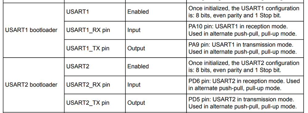

Parity and all as in AN2606 ?
2023-01-27 11:13 AM
yes. I used 9600 baud rate, 8 data bits, 1 stop, even parity and no flow control. Thanks
2023-01-27 11:34 AM
Are you using pins PC11 and PC10 (for USART3 on the Nucleo board) as stated in AN2606?
It sounds like it will be necessary for you to develop your own bootloader in order to have control of the RS-485 bus direction on your board.
2023-01-27 11:52 AM
I use PB11 and PB10 for USART3. Not sure which is USART3 by default . I will see if I can wire PC11 and 10 out and talk to bootloader thru' those pins. I am also trying to find RS485 chip with auto direction control and see if that helps. Thanks
2023-01-27 12:46 PM
L151 ? USART3 isnt in AN2606
