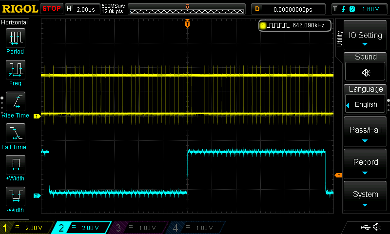

got it working.
what STM could do better:
so you know, blocksize is not in bytes , but in size of transfer element (maybe byte or 16...32 bit)
now correct timing on 32bit data:
--- what was not possible with I2S - although no fault is in errata about i2s not working if data > 16 bit.

2023-01-28 3:54 AM
got it working.
