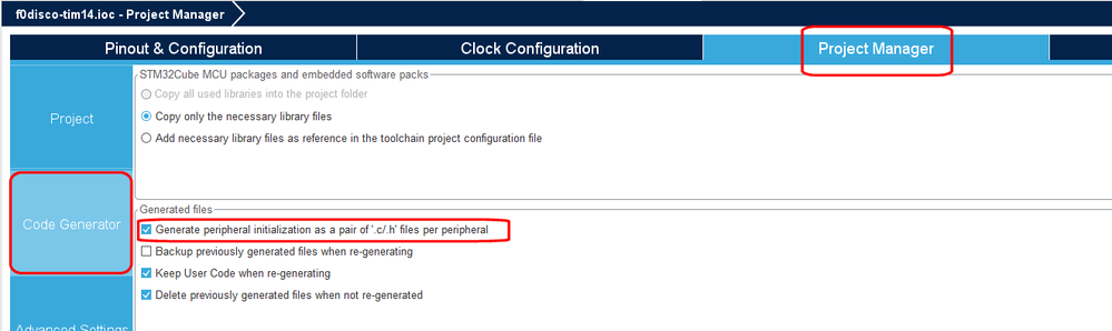

Try using the option to have CubeMX generate the initialisation functions in separate files:
That way, the initialisation functions will not be static.

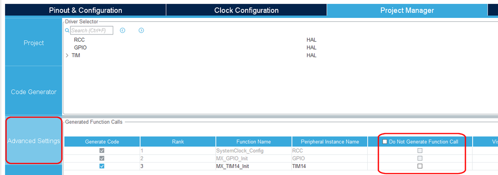

Note that there's also an option to have CubeMX not generate a call to the initialisation function - so that you can call it yourself wherever & whenever you like:

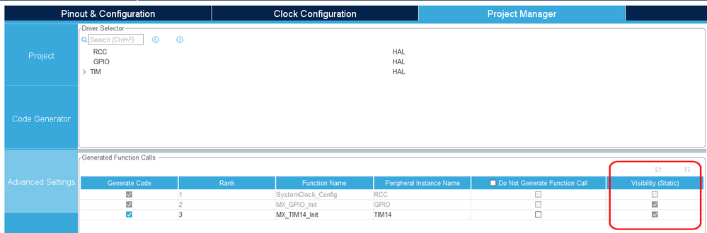

There's also an option to make the functions static or not:
(this seems to be ignored when generating separate files)
