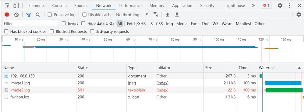

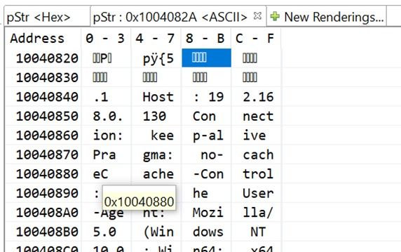

But when the code below was called for “image2.jpg�? I found “buf�? is normally corrupted with leading zeros.
netbuf_data(inbuf, (void**)&buf, &buflen);Looking at the “buf�? I can see the original HTTP request, but the ETH driver/DMA/?? has overwritten the start with zeros.

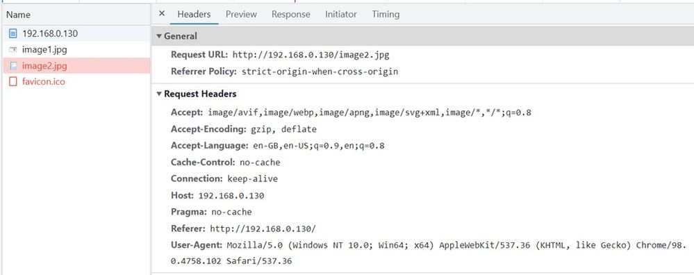

Looking at the web browser I can see the actual request is valid.
When the web server sees an empty string it returns back with 501, and the image is not loaded.

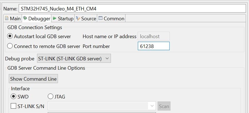

I’ve included the whole project as a zip file. If you debug it you need to change one of the debug configurations to use a different GDB port number, eg 61238, otherwise it will clash.
