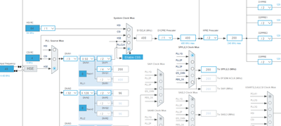

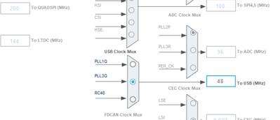

Hello @Igneous
Could you share with us your system clock config please?
2025-03-21 5:13 AM
> nucleo H755ziq
> external 48mhz crystal
This board doesn't have a 48 MHz crystal. It does have a 8 MHz clock source from the ST-Link chip which is connected by default. Note that 8/48 = 0.1666 so maybe your clock source is just wrong (HSE_VALUE).
2025-03-21 5:16 AM
this should do for that
2025-03-21 5:20 AM

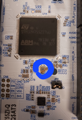

The 48mhz crystal is custom fitted to the board.
2025-03-21 5:39 AM
Did you also modify the solder bridges appropriately so that it's connected?
Toggle an LED with HAL_Delay(1000) between to ensure clock is correct if you can't verify on a scope.
2025-03-21 5:52 AM
You are indeed correct that it seems to be using the 8mhz crystal. Changing the HSE value to 48mhz does not seem to have change the actual speed. It's running at 8mhz. Ill have to talk to the person who soddered it on to ask how or why Im unable to change the frequency of it. Kind of odd. I can though funnily enough use the 8mhz to reach my 10ns goal, so it's whatever I suppose
