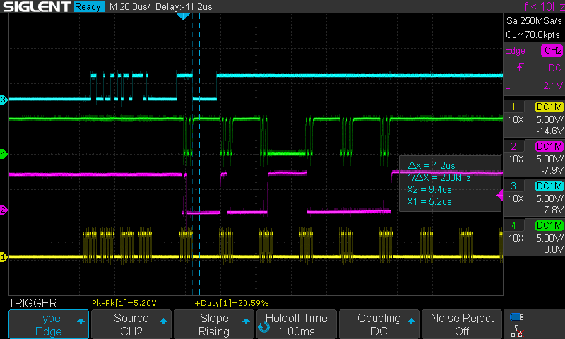

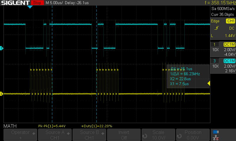

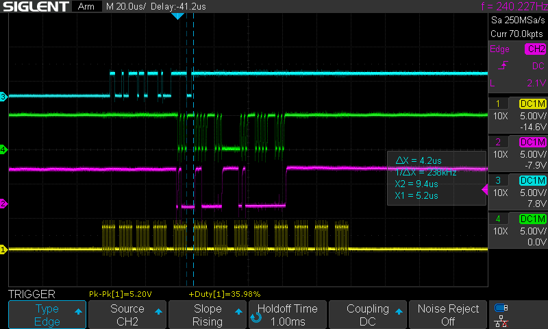

Below are clock and MOSI signals aforementioned with 15 us pauses between.
The code which calls HAL_SPI_TransmitReceive(...) is also attached.
Pauses between bytes

Slow (Cube MX generated about 20 us pauses):
Slow (STM32 HAL)
Faster version (still with pauses but only 4 us):
Fast
