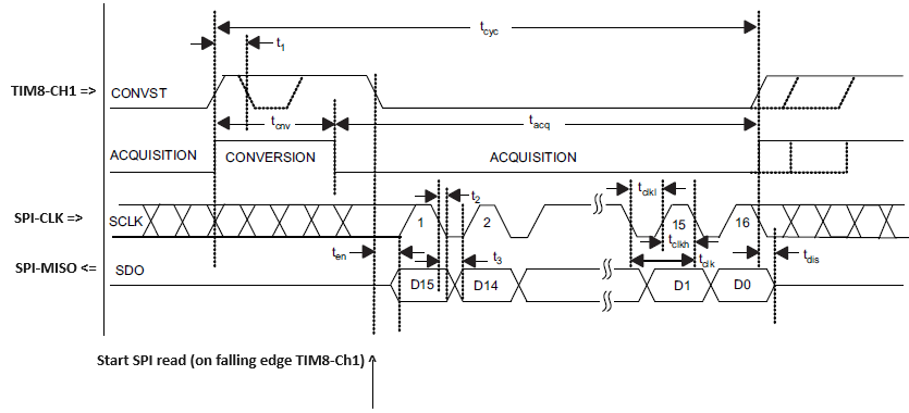

I want to digitize the analoge output of a linear CCD by an ADC with SPI interface. This ADC (ADS8319) needs a rising edge to start a conversion and >1.6us later it expects a serie of 16 Clock pulses to export its data. I have read an attractive solution for such challenge at the 'StackExchange' site, that sends dummy uint16 data to a SPI with DMA, triggered by a Timer.
A SPI in Full-Duplex mode, will produce 16 Clock-pulses to transmit an U16 word. The Timer must produce PWM pulses with the wanted frequency for the CCD readout. The rising edge of the pulse will trigger the ADC conversion, while the falling edge triggers the DMA transfer of a dummy uint16 to SPI, that produces the Clock-pulses needed by the ADC to export its data. The ADC's uint16 data is sent to the SPI MISO pin, to let it be transferred to the global data-array by another DMA action. The scheme below shows the timing:

You may have been I misled you by my description of my configuration of the SPI peripheral: "Full-Duplex with HW NSS control". The reality is: I left the pins for SPI MOSI and NSS un-connected and applied the TIM8-CH1 PWM pulses on the CNVST input of the ADC. The timing scheme for '3-Wire CS Mode Without Busy Indicator (SDI = 1)' on Datasheet page 20 shows the following, I added my signals at the left and below:
I may seem a stubborn old ***, but I think this approach should be able to work (assuming I manage to program the SPI-read part). I already had a working situation with such layout, but running on a STM32F401CCU6 with an interrupt on TIM8 by DIER.CC1IE. The ISR was simple:

> I had the impression the MCU could not handle 125k interrupts per second in a timely manner
At 84MHz system clock, you had 672 machine cycles per interrupt. While the ISR entry/exit, C function prologue/epilogue, qualifying the interrupt source and clearing it, may take around 50 cycles - maybe a tad bit more, if the ISR does nothing but pulling a variable and storing it into a peripheral register, that may push towards 100 cycles. Out of the 672. That's more than enough, provided you don't use other lengthy interrupt (e.g. USB) with the same or higher priority.
What I guess choked your mcu was the overhead brought in by Cube's method of handling the interrupts, possibly exacerbated by not using compiler optimizations.
