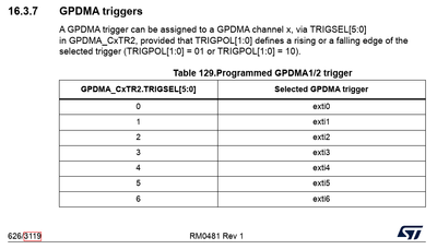

You have to read in rm of your chip, whats possible on this chip, here example from H563 manual, GPDMA :
pin on exti mode -> trigger on rising or falling edge :
Then you know, whats possible on this chip.

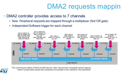

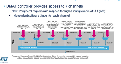

Here's what I've been looking at for the STM32l432KC, It's difficult for me to parse out what I'm looking at. I don't explicitly see any GDPMA or GPIO events. I do see plenty of TIMx_CHx.
From what waclawek.jan said, any TIMx_CHx feeding the DMA controller set in input capture mode should be able to trigger a data transfer on a selected edge. Correct?

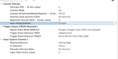

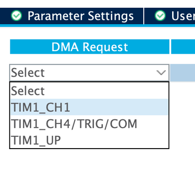

Here's the settings for TIM1 in CubeMX I think I need for input capture:
No clock for input capture, Trigger event selection? Do I need one, or do I use TIM1_CH1 for the DMA? What is TIM1_CH4/TRIG/COM, compare match. I don't think that's what I need? Can I use TIM1_UP?
I suspect I want TIM1_CH1.

Ignore TRG0, this is for triggering one timer from another, not relevant to your task.
Timer Input capture is a way to trigger an event from an external pin. a DMA from TIM1_CH1 is what you want but be aware that CubeMX will not do what you expect. It will program the DMA trigger source appropriately, but the provided HAL_TIM_IC_Start_DMA API hardcodes the peripheral addr for the DMA to be timer->CCR1. Not what you want. You can however copy HAL_TIM_IC_Start_DMA into your own function and easily modify it to DMA wherever you want.
I'm literally having this same conversation right now in another thread. This is a pervasive usability issue with CubeMX, and I'm going to open a bug report thread about it.
Configure the input capture section to trigger on whatever you need, rising/falling/both. That's what determines when an event is generated, and whenever that event is generated a DMA trigger will occur.
