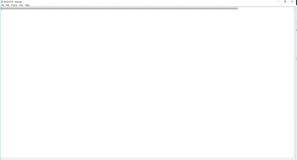

uint16_t wtext [192] = {[0 ... 191] = 1000};
UINT wbytes;
res1 = f_write(&SDFile, &wtext[0], sizeof(wtext), &wbytes);
Then I get the following in the text file:

2018-01-23 9:32 AM
Perhaps look at the file in a viewer that can show you the binary content.
1000 as 16-bit words would appear as
E8 03 E8 03 ...
Not printable ASCII words, not human readable. Data is represented in a machine readable form, the byte order would depend on the endian format the machine uses.

2018-01-23 9:38 AM
C:\CT\MSVC>dump test.out
00000000 : E8 03 E8 03 E8 03 E8 03 - E8 03 E8 03 E8 03 E8 03 ................00000010 : E8 03 E8 03 E8 03 E8 03 - E8 03 E8 03 E8 03 E8 03 ................00000020 : E8 03 E8 03 E8 03 E8 03 - E8 03 E8 03 E8 03 E8 03 ................00000030 : E8 03 E8 03 E8 03 E8 03 - E8 03 E8 03 E8 03 E8 03 ................00000040 : E8 03 E8 03 E8 03 E8 03 - E8 03 E8 03 E8 03 E8 03 ................00000050 : E8 03 E8 03 E8 03 E8 03 - E8 03 E8 03 E8 03 E8 03 ................00000060 : E8 03 E8 03 E8 03 E8 03 - E8 03 E8 03 E8 03 E8 03 ................00000070 : E8 03 E8 03 E8 03 E8 03 - E8 03 E8 03 E8 03 E8 03 ................00000080 : E8 03 E8 03 E8 03 E8 03 - E8 03 E8 03 E8 03 E8 03 ................00000090 : E8 03 E8 03 E8 03 E8 03 - E8 03 E8 03 E8 03 E8 03 ................000000A0 : E8 03 E8 03 E8 03 E8 03 - E8 03 E8 03 E8 03 E8 03 ................000000B0 : E8 03 E8 03 E8 03 E8 03 - E8 03 E8 03 E8 03 E8 03 ................000000C0 : E8 03 E8 03 E8 03 E8 03 - E8 03 E8 03 E8 03 E8 03 ................000000D0 : E8 03 E8 03 E8 03 E8 03 - E8 03 E8 03 E8 03 E8 03 ................000000E0 : E8 03 E8 03 E8 03 E8 03 - E8 03 E8 03 E8 03 E8 03 ................000000F0 : E8 03 E8 03 E8 03 E8 03 - E8 03 E8 03 E8 03 E8 03 ................00000100 : E8 03 E8 03 E8 03 E8 03 - E8 03 E8 03 E8 03 E8 03 ................00000110 : E8 03 E8 03 E8 03 E8 03 - E8 03 E8 03 E8 03 E8 03 ................00000120 : E8 03 E8 03 E8 03 E8 03 - E8 03 E8 03 E8 03 E8 03 ................00000130 : E8 03 E8 03 E8 03 E8 03 - E8 03 E8 03 E8 03 E8 03 ................00000140 : E8 03 E8 03 E8 03 E8 03 - E8 03 E8 03 E8 03 E8 03 ................00000150 : E8 03 E8 03 E8 03 E8 03 - E8 03 E8 03 E8 03 E8 03 ................00000160 : E8 03 E8 03 E8 03 E8 03 - E8 03 E8 03 E8 03 E8 03 ................00000170 : E8 03 E8 03 E8 03 E8 03 - E8 03 E8 03 E8 03 E8 03 ................2018-01-23 11:07 AM
Thank you Clive,
I completely understand now. I opened it with a binary file viewer and saw the logged data.
