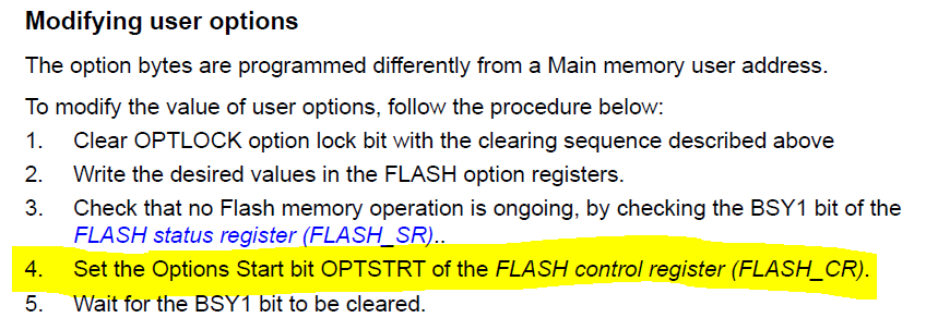

Option bytes need loaded by setting OPTSTRT. Not sure if you can set this via the UART bootloader, but it's worth trying.

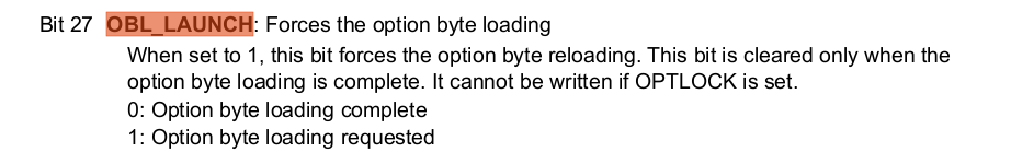

and I found a small note regarding the FLASH control register (FLASH_CR) bit 27 OBL_LANCH:
which is executed by HAL_FLASH_OB_Launch(); to force the option byte loading, that it cannot be written if OPTLOCK is set,
but if you reverse the sequence in your code to call HAL_FLASH_OB_Launch(); function while you unlocking the option bytes, it will generate a reset and prevent you from lock the option bytes again, which will break the board, and you will not able to communicate to your MC any more with anyway and it will not run the software either.
