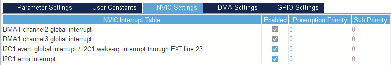

I have configured my I2C module to enable DMA and interrupts:
I can confirm that my call to HAL_I2C_Master_Transmit_DMA returns OK. I can also confirm that the generated DMA1_Channel2_IRQHandler is called. That's where things start breaking down.

My deepest thanks for both the accuracy and promptness of this answer. It is exactly what I was looking for.
Aside: should I be disabling the I2C interrupts from MX, if all I care about are the DMA completion callbacks?
2025-10-20 9:51 AM
In general, you should not disable interrupts that CubeMX has configured.
In this specific case, I believe the I2C interrupt is needed to trigger HAL_I2C_MasterTxCpltCallback. If you're disabling it, you won't get HAL_I2C_MasterTxCpltCallback and also the software state machine (I2C handle) may not get updated correctly.
The DMA TC flag gets set but doesn't call HAL_I2C_MasterTxCpltCallback since the transaction is not actually complete. DMA TC indicates the data has been sent to the I2C and the DMA is done with its job but not that the I2C has sent it out--it is still mid-transaction.
