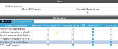

Je crois pourtant avoir validé les interruptions :

However, I believe I have validated the interrupts:

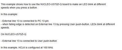

Here is the descriptif:
Humm well. That seems to be this example from Github:
https://github.com/STMicroelectronics/STM32CubeU5/tree/main/Projects/NUCLEO-U575ZI-Q/Examples/GPIO/GPIO_Demo
Indeed you can start by that one. Then move on with this one (GPIO_IOToggle_TrustZone):
https://github.com/STMicroelectronics/STM32CubeU5/tree/main/Projects/NUCLEO-U575ZI-Q/Examples/GPIO/GPIO_IOToggle_TrustZone
at least to inspire from the TrustZone configuration/implementation.
For SPI example refer to these examples (I think without TrustZone enabled): https://github.com/STMicroelectronics/STM32CubeU5/tree/main/Projects/NUCLEO-U575ZI-Q/Examples/SPI

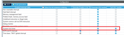

Check if the option to generate the system tick interrupt handler code is checked in the code generation tab:

Thanks  @mƎALLEm and @StevenG  for your responses.
 @mƎALLEm : Yes the option to generate the system tick interrupt handler code is checked in the code generation tab:

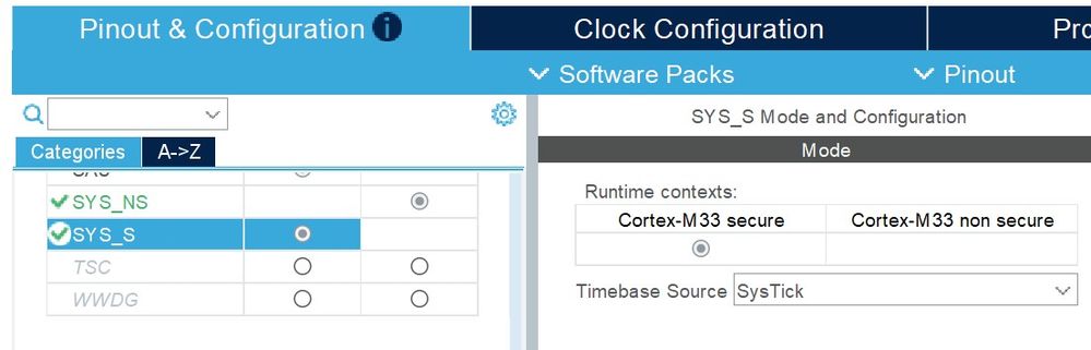

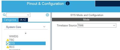

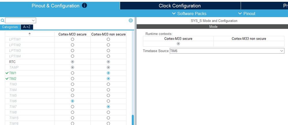

What do you have selected as the Timebase Source in the CubeMX project?

No I can't select TIM1, SysTick is the only possibility, all other proposals are grayed out...
The code runs on the physical hardware NUCLEO-U575ZI-Q, I am currently creating a prototype with an SPI display and a Quad SPI flash that will interface with the Nucleo board via the expansion connectors.
I haven't used the secure code features of the U5 series but you can see the HAL_IncTick() being called from the SysTick_Handler() in both ./Secure/Core/Src/stm32u5xx_it.c: and ./NonSecure/Core/Src/stm32u5xx_it.c
You have the Timebase source set as SysTick so I would suggest either stepping through the code using the debugger or grepping through the source code on a terminal and figure out if SysTick is getting set up correctly.

I
I believe you need to select which domain each timer is in, secure or non-secure.  Then it will be available as a Timebase Source.  I haven't used any of the secure features yet so I can't give much more support.
